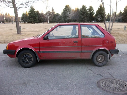

I put 13" Honda Civic rims on mine. The Honda centre bore is smaller so I used 8mm spacers. Worked great on the front but required a little grinding on the rear (I did mine on the hub bore on the drum). Also makes the rims lug centric instead of hub centric so you need to be a bit more careful bolting on the rims.
13" Civic rims on the front and 12" Micra rims on the rear. Quite the size difference. I've since got the matching 13" rims on the rear.
