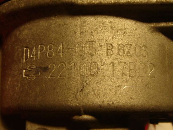

hi lewis! so glad to hear from you. i sent you a mail before but no reply! the dizzy does have a nissan emblem on it and a part number.
http://www.micra.com.au/images/community/forums/10211.jpg

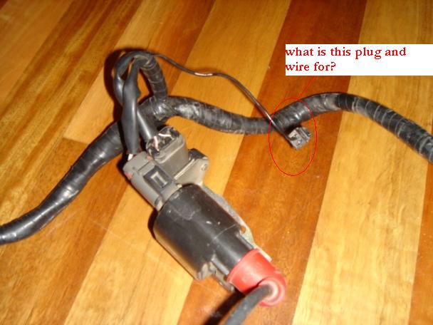

there is a wire hanging off the harness which is marked tachometer. which wire were you talking about? were you talking about this one?
http://www.micra.com.au/images/community/forums/10219.jpg

so you dont wanna open the ECU. okay. you need to strip the loom down to ea wire. label them, document them, whatever. you need to get the pinouts for that ECU, badly. once u have pinouts, you are SET !

i do'nt think the mark on dizzy means "nissan", that should means "hitachi"....made by hitachi...
and the harness on pic 019 should be tachometer.....
