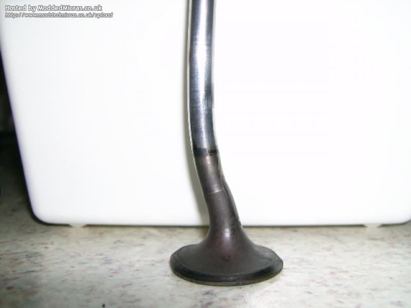

62thou off it christ!! dont over rev it,My race engine's got 50 thou off it and when it jumped out of gear early this year when i was racing and this is what happend....AND I HAVE 4 LIKE THIS....
O horse ####.
What would you say is over reving it? I go to 6k on a regular basis. Well iv been running it on 50thou for a far few miles and has been ok. Compression will be through the roof, or bonnet if it goes wrong. ha ha.
