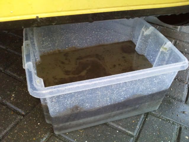

Car died at ace cafe and would not start, thought it was due to the fact that I parked it on a steep incline with the nose down.
Mechanics there suggested putting it on the flat, taking fuel cap off and removing air filter. Got it running after about 10 mins. On drive home it was good as gold.
Next morning would not start, kept idling at 200/500 revs.
Gone to look at it now and this is what its like?
Blown head gasket?
How much am I looking at for repair costs?

oh no...that looks like one oily rag!!!
do you have condensed emulsion (mayonnaise) on the inside of teh oil filler cap?
either way it looks like a head gasket check/(replacement anyways since you have the head off)...but yes, it is not so bad of a job if you have somewhere warm dry and light to do the work (no hurry)...

That's pretty unusual. I have never seen that much oil get into the water like that. I wonder if something more sinister is going on. Either way, get it out pronto. Oil sitting in the rad pipes really doesn't do them much good they will go all soft, and need replacing. Make sure you wash all the water ways out with some kind of detergent to get the oil residue away.

It's a sod and costs a bloody fortune! But.........I have good news . . .
Before it was running like this:
Drained and flushed the system
It was running like this at about 5
By 7 I was able to get it driving. :D Will try to get it down to garage asap.
Yes don't drive it. The oil got in there somehow. I wouldnt have even started it until I could see why that had happened.

Quick update, couldn't get the car to Ed's so a mate who specialises in Skylines came round to help.
It's gone, Head gaskets, piston rings etc etx. Talking to my mechanic in the morning for his opinion on a replacement but I'm hoping the CA18det is the prime runner.
