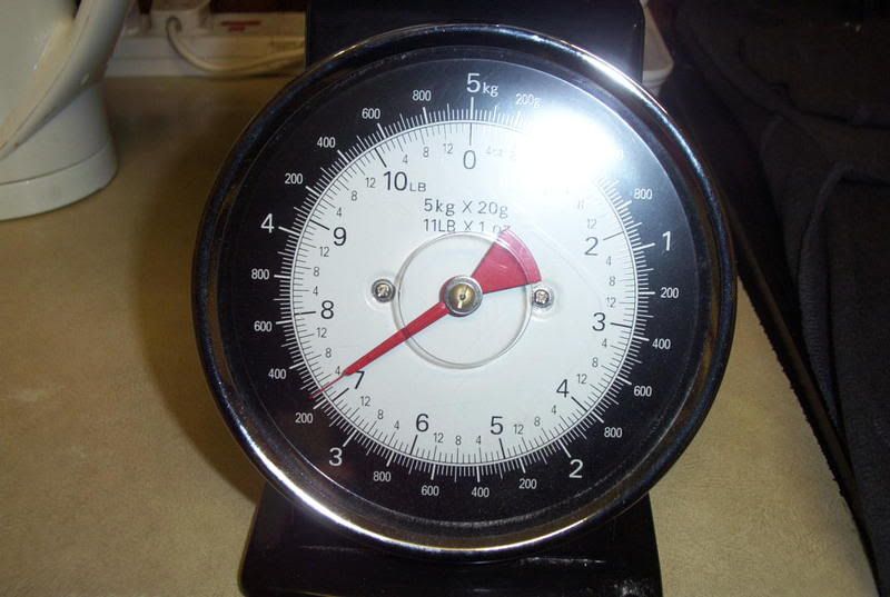

its a smidge under 4kg btw (friendly local post office scales :wasntme: )

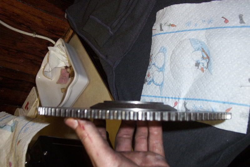

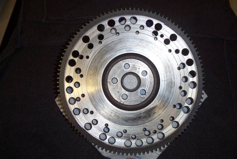

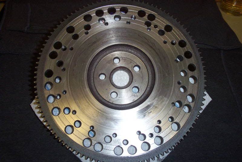

well im all in, had me tea, but tonight im armed with a couple of pics,
and weighing in at
just need to get a bearing in the morning to balance it. odd size the centre bore 27.35mm
