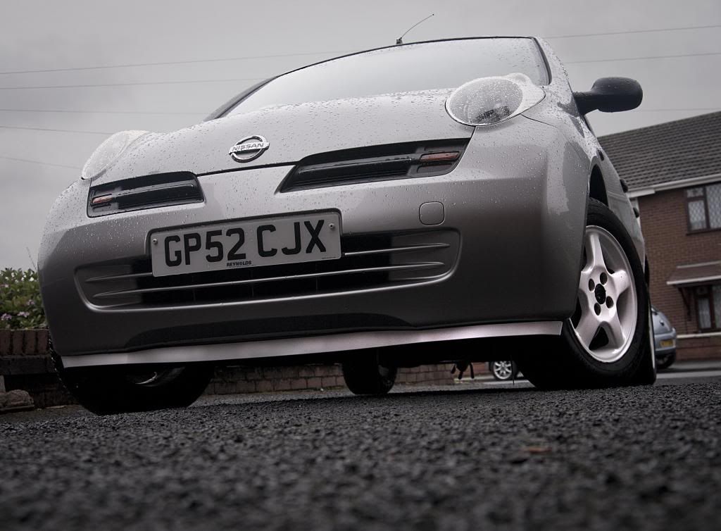

Heres one from a few months ago...
and one from a few days ago, just to give you an idea

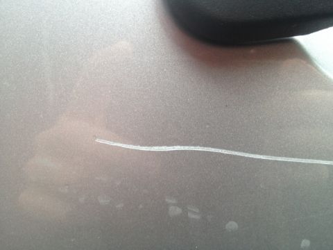

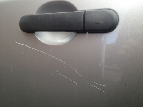

Well it seems bad things come in 3’s and the past few weeks have proven that. first of all a dozy postman managed to leave a nasty scratch along the passenger side! After a few phone calls royal mail agreed to cover the full cost of the repair so i cant really complain. About a week later i received a cheque through the post and the was re-sprayed in no time! i cant really fault the job the garage did, they had to spray both doors and in the process got rid of a nasty paint blow out from a previous repair - winner!

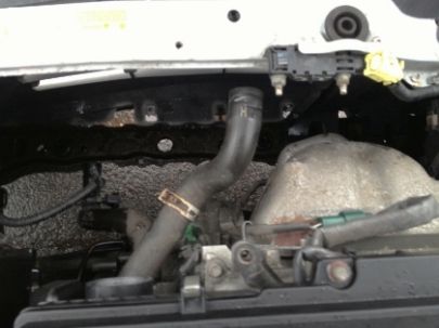

It was time to sort out my radiator! After finally having some time off work, and getting a mate to lend us a hand to make the fettling easier. I managed to source a new radiator on ebay for £34 which i thought was a bit of a bargin :cool:. After consulting the Haynes manual, which recommended removing the front bumper. well, we both decided B*****ks to that and got cracking.
All pipes & rad removed
After detaching the fan & removing all the hoses - and getting a mouthful of coolant in the process (not the nicest taste :eek: ) there was only two bolts holding the rad in on the bottom slam panel, after removing them it was a case of wangling out the rad.
new rad ready to go back in
Before i put the new one in i attached the fan & other gubbins back on and slid it in through the top of the engine bay. The only pain was getting the top pins to sit properly in their rubber mountings (this is where a second pair of hands definitley came in handy). It seems the new rad has sorted out the problem - the Micras running like a dream again :).
