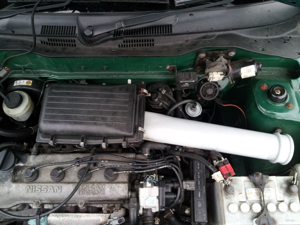

14.4, thats very generous :D around 14 is good enough with an aged alternator. I found that if you look to the right of the engine bay there is a red connector about an inch square, 1cm deep. Goes from battery, alternator and starter motor I do believe. that connector melted causing a restriction to charge the battery. and too and from the other connectors. See if the connector has not melted and cause this issue.. just a suggestion.
