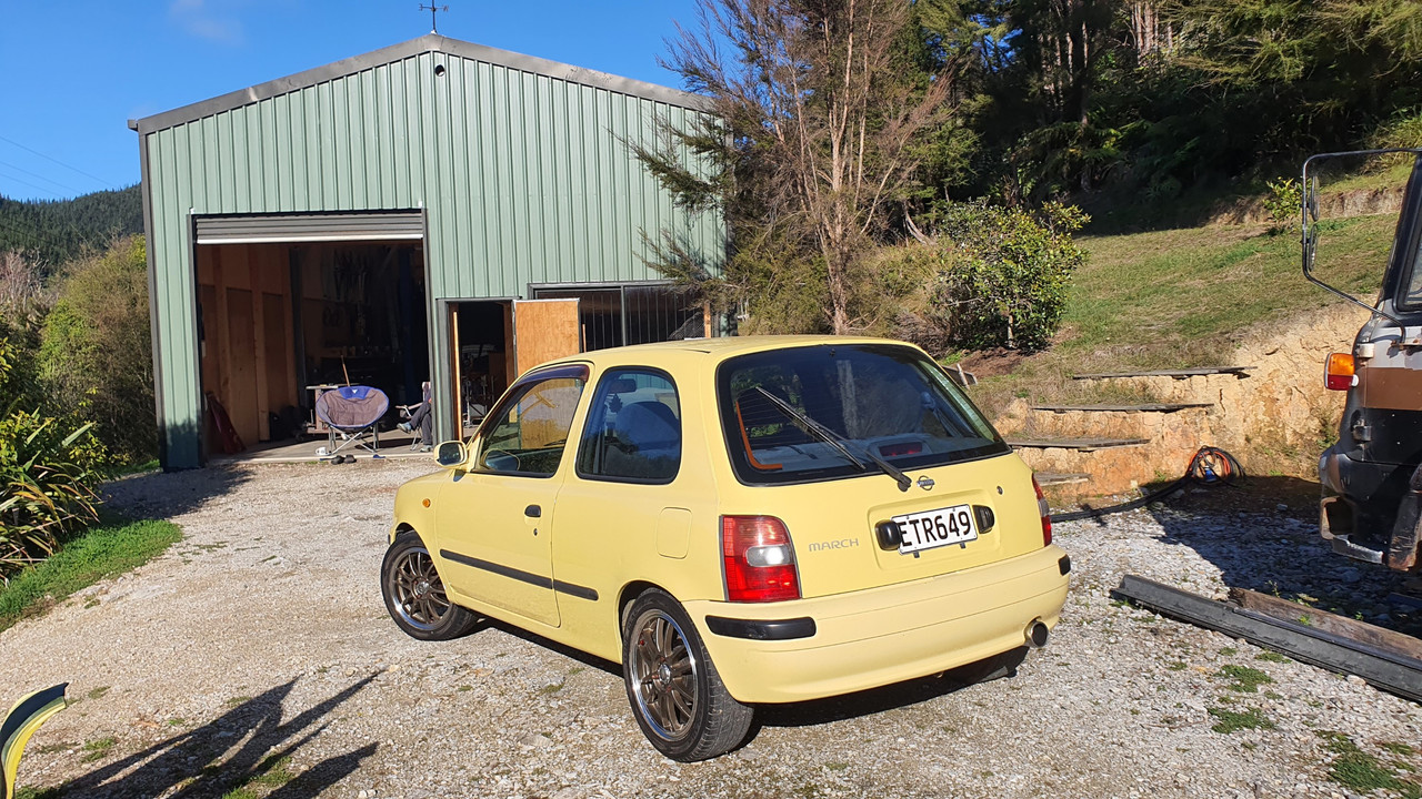

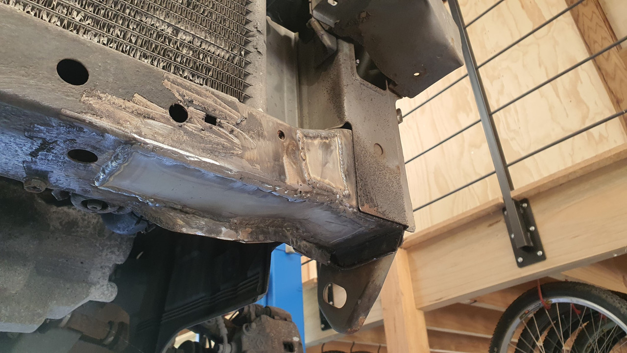

Martha is now in fine fettle and about to go up for sale. But before I do a listing I thought i'd do an update here.
She went up on the hoist and I removed all the front bumper/lights/guards etc.

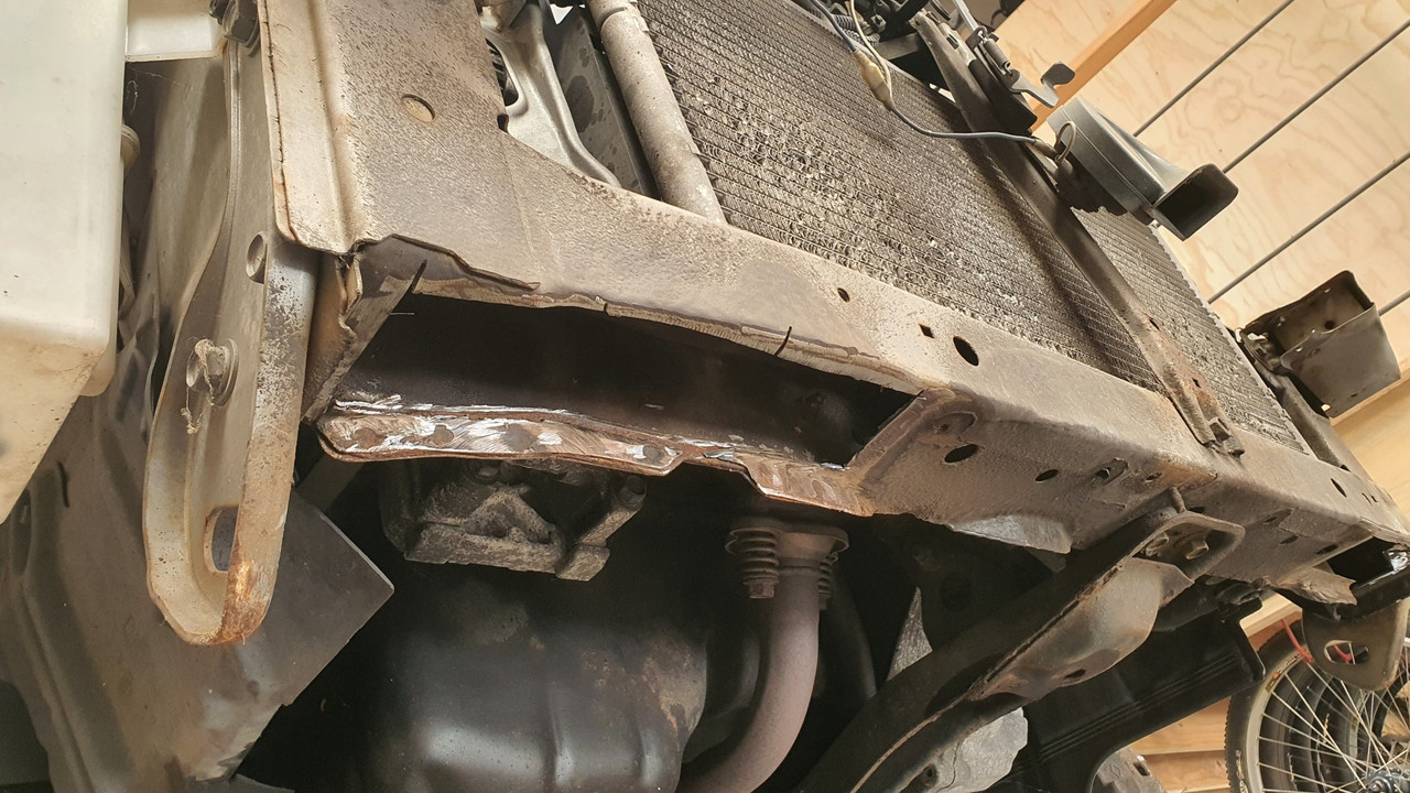

The rust that she had failed her last wof on was all along the bottom of the radiator support - probably the most typical place for NZ k11s to rot.
Cut it all out and let in new steel. Pics explain it easier..
Phew. Done. Gave it a good coating of paint. Then while the guards were off I cut out the rotten corner on one and let in new steel..
While up on the hoist I gave the underside a clean, check over and quick tart up with some of the ever magical CRC Black Zinc 'new car in a can'...
Then the surface rust around the windscreen. It looks like it had been flagged for rust, the previous owner then started cutting away the sealing trim around the screen and gave up. I cleaned it right out, wire brushed it back, painted a POR 15 type inhibiting paint around the full perimeter. More pics..

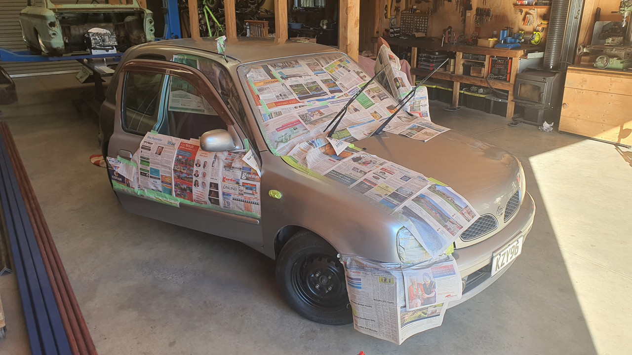

Then masked the car up and gave it some sparkle with a can of colour paint. It came up fine. Nothing flash but far better than what it was like when we got it plus now solid. There was a dent on the drivers guard, 'fixed' with poorly applied filler. I did my best to tidy it up, feather it in and paint it with the small amount of patience I could muster up and its improved but certainly something that needs more love.
Then this stupid bloody sticker...
Heating it up, very carefully, allowed me to peel the 'JDM scene' off without leaving a trace.

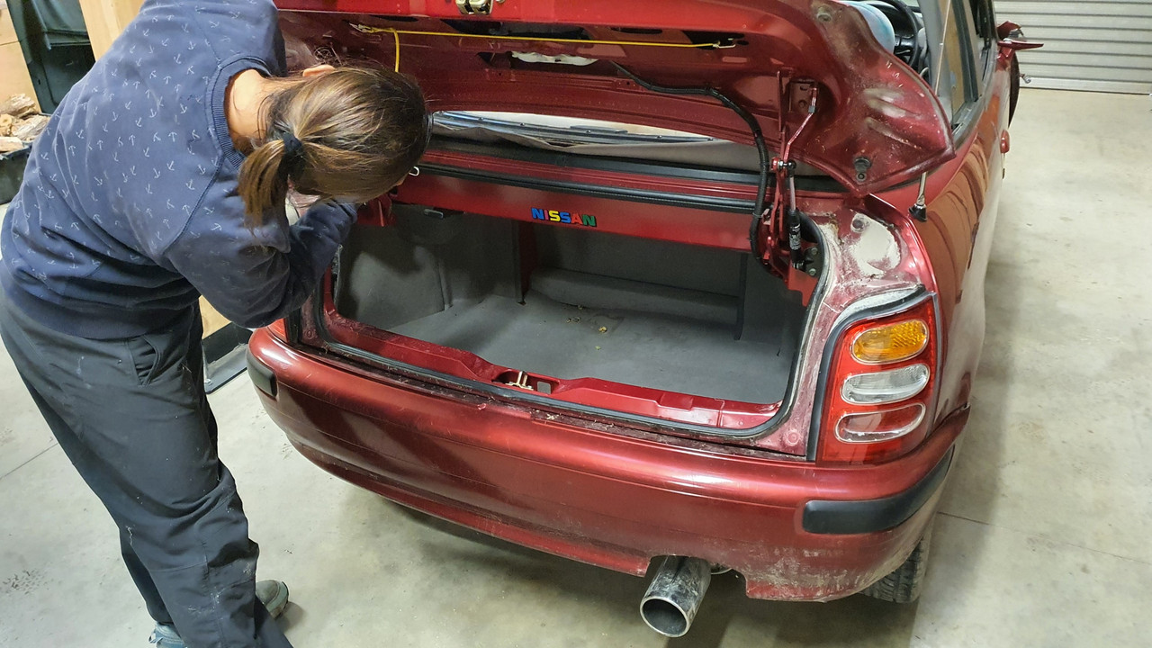

Hannah spent some time tending to the usual little surface rust spots k11s get under the rear boot seal and add some aluminium tape over the holes that we've learned through experience can allow water in..
Se also replaced the brake pads for some almost new items we scored from the wreckers...
We had fitted the spare wheels from Molly but one was worn so a good tyre was sourced and fitted. Then we took her for a wof and she flew through with flying colours. There was a chip in the screen that was noted and we already knew about however it was not in a zone that mattered.
Still, just to be sure, we had our friendly glass man squirt some of his magic goo into the crack while Hannah watched with keen interest...
While he was there he also tended to a tiny chip on Minkys screen.

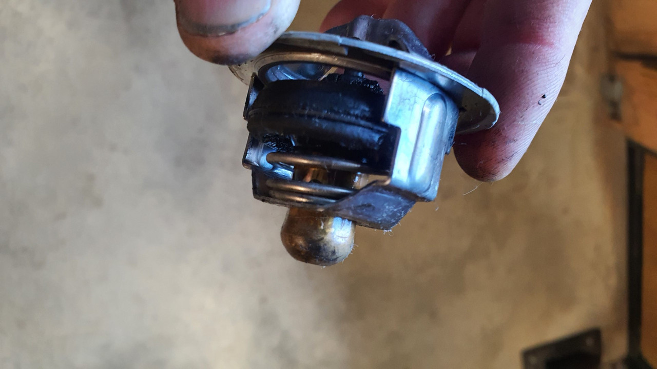

The wof pass was about a month ago. We've been driving her about and watching for any issues and the only one that I noted was how slow she was to heat up. I suspected a removed thermostat and had mild alarm bells ring however she never used water nor heated up beyond normal. I pulled the thermostat cover off (noting that there was still factory grey sealant present) and happily discovered that there was still one in there, stuck open and looked to be the original Nissan item..albeit very stuffed..
I swapped in a spare we had kept from Molly and it heats up properly now.
She drives really well. Very peppy, seems to be as thrifty on fuel as they should be too. Handles well but very stiff on what seem to be even stiffer springs then whats fitted to Minky. Really fun on the right roads but a little tiring if you're just wanting to cruise A to B. We've taken the squeal free wheels that we'd swapped on, fitted them to Minky and Martha now wears Supercats on the front for maximum squealing delight
So that is that. Took some nice photos of her the other week. We will now list Martha up for sale tonight on Trademe (because its free car listings tonight) and see what sort of interest there is.

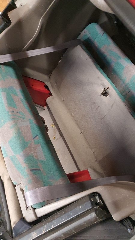

Huge boot..
Pull a lever and pop the back seat down for the skis/ironing board/golf clubs/ french sticks...

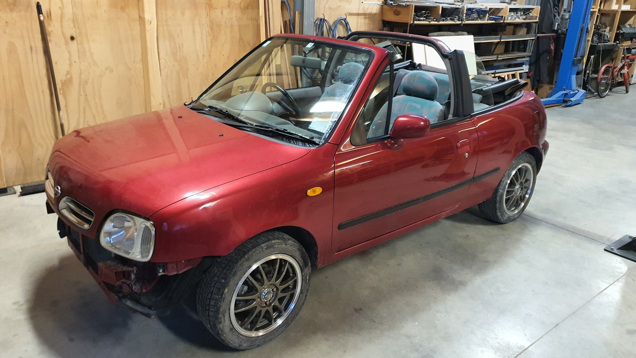

Mandy first. We stripped her down, removing both guards. Only needed to remove the drivers side to fix damage but as we've learned they all collect a load of dust/dirt at the back bottom of the guard so its worthwhile removing to clean it out. Took off the bumper and the headlights.
It looked like this behind the bent wing.. (I took no photos. These 2 following pics are screen captures from a video I had sent my brother. Yes. He's that lucky)
I then used many various tools including hammers, slide hammer, dollies, vice grips, pliers, blocks of wood, long lengths of steel etc to carefully reshape the inner guard front until it sat where it should. Lobbed some black zinc on and fitted the white guard we had scored from the parts car at the wreckers.
Then I had to fix the bonnet corner. Same again.. lots of tools and some patience rewarded me with a bonnet that you'd hardly tell was damaged but for black paint and some dents.
Classy.
The headlight next. Turns out the back of it was smashed more than I thought and its not one that's so easily found locally , the car having facelift 2 lights, among other 'updates' (even though on the tintop cars facelift 2 updates didn't happen for 2 more years. Maybe the cabs were used as a test bed. Or maybe they were seen as extra special, got these new upgraded bits and then the thought to fitting on the tintops 2 years later? Very interesting I know! I can tell you're impressed )
So the headlight. It got some Barry levels of diy plastic welding using a big soldering iron, plus some riveted on alloy brackets. Shame I did not get a photo. Its beautiful. I earned extra milk arrowroot biscuits for that effort and was talk of the blokes shed that evening.
So now the front end looked straight and the headlight pointed in roughly the right direction we swapped the alloys over onto Minky and Minkys steels went onto Mandy. Then we went for a drive to town. I spotted another local k11 and nabbed this shot to the amusement of the other carpark dwelling folk..

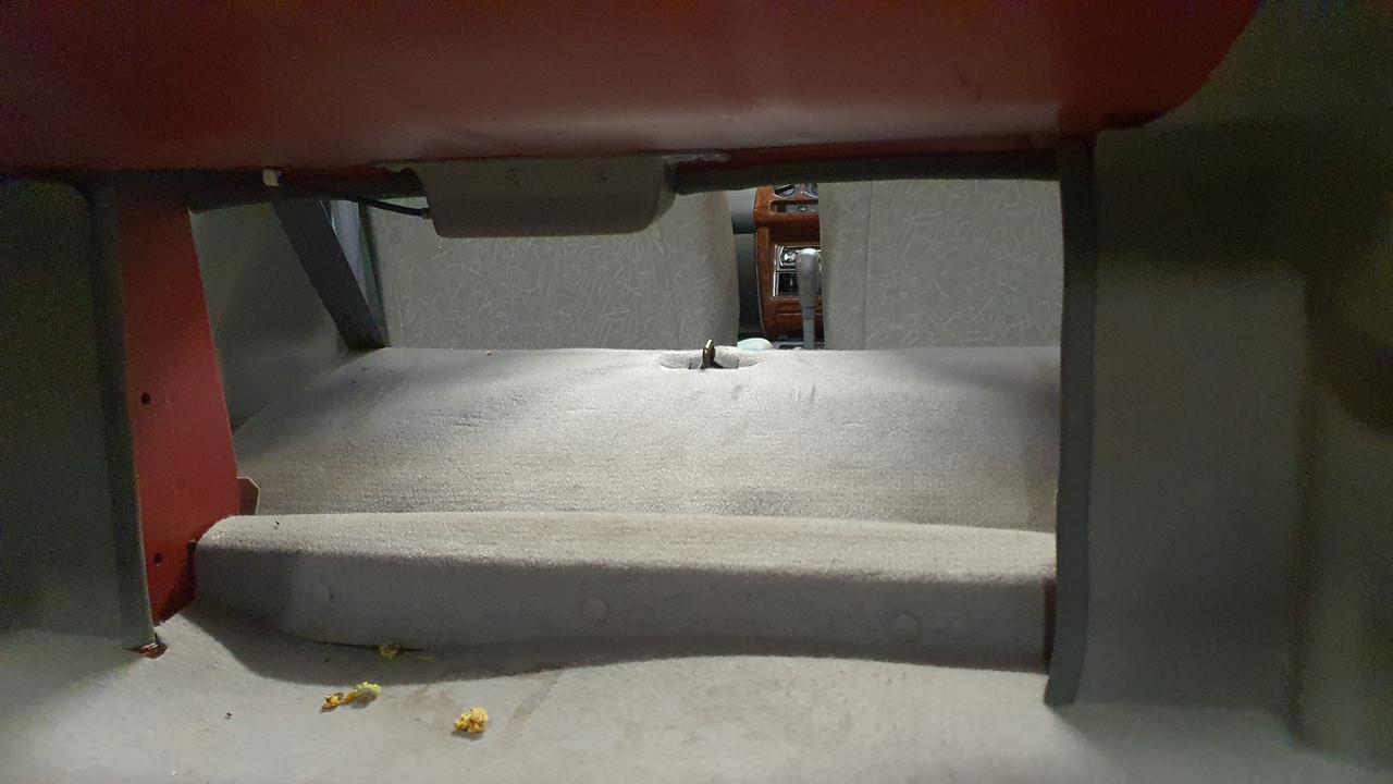

There was also this unit under the passenger seat. Some sort of television control? Figuring this car must have had the very latest in car entertainment back in the day...
Next major job was to make a side window. I had rang about various wreckers all over NZ looking for one but no luck I even emailed the main garage in the cook islands where there's apparently loads of these cars but no luck there.
So a plastic window it is. Anyway- its a convertible. The windows shouldnt be up when you're driving. I got a bit of plastic big enough from a Nelson outfit (bendy stuff that doesn't crack - not sure what) and we removed the passenger window.
Actually a really easy and quick job which was a relief. Used it as a template and traced around it, cut it to shape plus measured the curve depth.
Dropped the plastic back in to the specialist and they heated it up and formed the curve. It turned out good. Fitted and now a window we have.

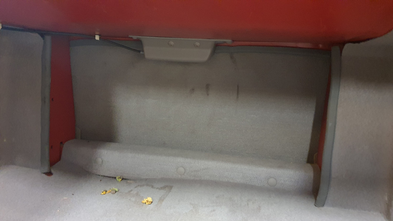

He likes the little nook he had under the seat...

So yeah- this little car has been great fun. Even used it to collect some alloy- the drop down rear seat centre was very handy...
