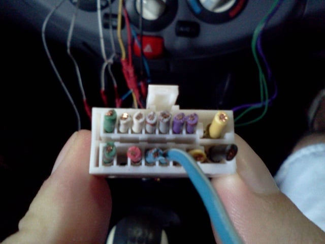

The car is currently fitted with an aftermarket stereo from early 2000 and has an aftermarket wiring harness. Unfortunately matching the wires from the existing aftermarket wiring and my new wiring has not worked.

Thanks guys still having a few probs... have wired new stereo to old aftermarket stereo wiring but headunit won't turn on.
Have used a multimeter and there is constant power from yellow wire - have gone yellow to yellow / red to red / black to black etc. Any thoughts on blue?
There's no power coming from red / blue when ignition is turned and there is no response from headunit with everything test wired.

...alot of those wires in the images you've posted look as though they were a bit messy before you even looked at them?
