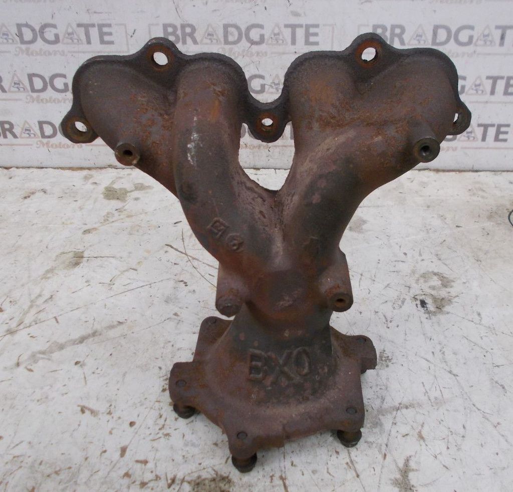

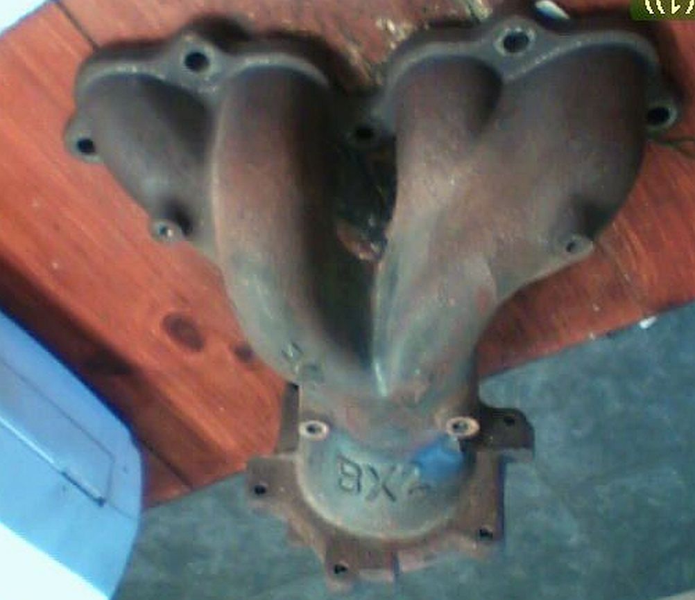

The head and exhaust port spacing and position of the manifold attachment studs is very different on the 1.6 engine Mika, so not really an easy practical solution. I have however found that the post 2005 1.4 exhaust manifolds, while still a cast item, appear to have larger porting/branches and look to be a direct bolt on replacement. I'm tempted to try and pick up one of those, then do some rudimentary port smoothing and polishing prior to fitting.......
1.2 (same as 1.0) manifold:-
1.4 manifold for comparison:-
Based on pictures, without measurements, 1.4 manifold looks direct bolt-on...?
Looks that way to me Mika, the 1.2 and 1.4 have identical exhaust port centres and stud positions on the head and as AFAIK the rest of the exhaust system, cat back, is identical on the 1.2 and the 1.4 post 2005 K12 Micras. The BX2 manifold is also standard fitting on the 1.4 Nissan Note....
