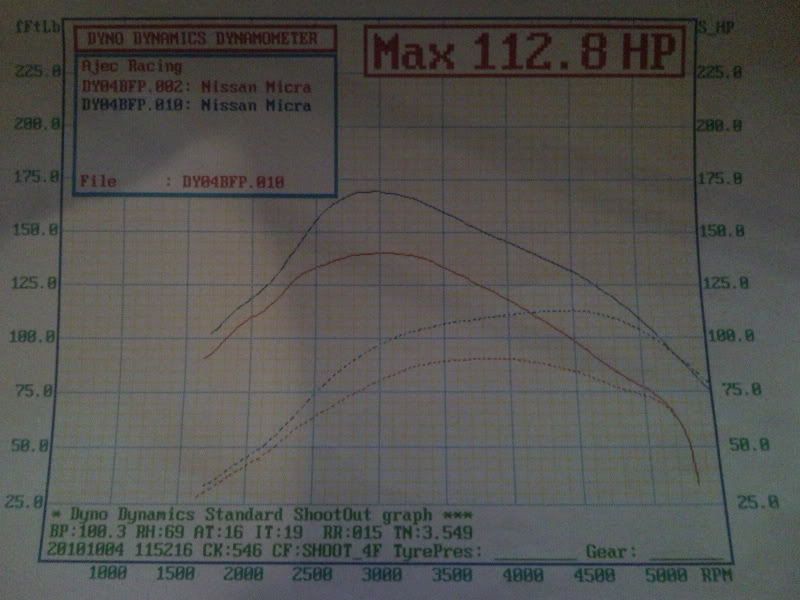

Originally it was the 82hp version, and with the addition of a k&n panel filter and a re-map its now 112.8hp @4500rpm and a smidge under 170lbs/ft @ 3000rpm.

Thats the graph, i don't have any pics of the car, its just a normal k12 sve in blue with a crazy cream interior lol. I would love to stick some coilovers etc on it tho if i had some extra dosh.

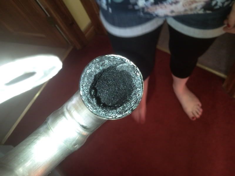

yeh i'm aware of that, apparently the turbo's on these micras are prone to failing too due to the egr valve clogging up. The first thing i did when i bought the car with 38k on it was whip the egr valve out and the inlet pipe connecting the egr to the inlet manifold (inlet manifolds part of the head casting so couldnt remove that). Gave it all a good clean, as it was pretty gunked up. Checked on it a couple of months back and there was a bit of soot in there but nothing like when i first took it apart. Along with this i service it every 6k with decent oil which is a third of nissans service schedule, so that should help.

Thats the pipe that links the egr to the inlet manifold before i cleaned it, best shows the amount of gunk

Ah rite i've never heard that. Some usefull info there cheers! When speaking to my workshop manager who mapped it, he said he ran a map that made 115hp on the car however the smoke was too excessive for the road so settled with this one. If your interested drop me a pm and i can get you some contact details for my work etc
