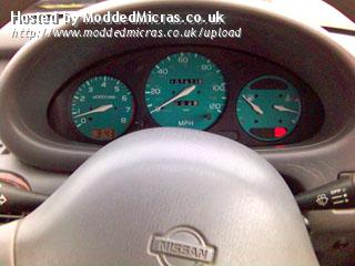

You can get dials with a tacho from the Super S, SLX, some S models and the SR. The S/SR ones have a green backing like this:

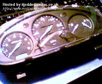

And the Super S / SLX ones have a black backing like this:
As far as wiring goes, some have the loom built in, some don't. I had to take a wire from the dizzy on my older K11.
