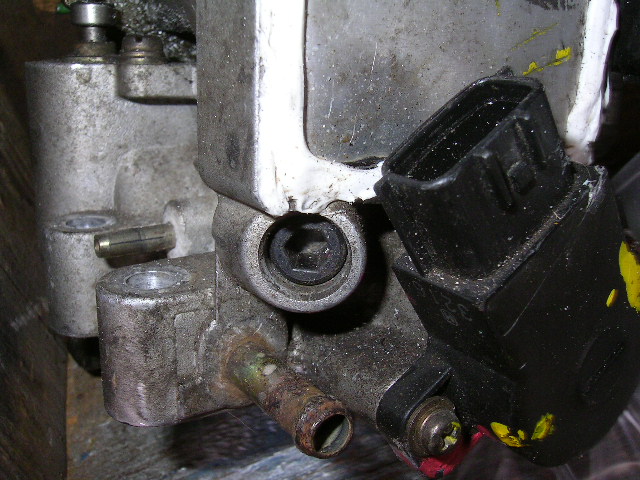

theres an idle speed screw on the left hand side of the throttle body ( sorry got no pic )
when cold the IAV should open and idle at 1200rpm
then once warm up it idles down to 750rpm
if it idles faster from cold then slows down when warm then the IAV's workin. if not, clean it.
then if the idle is too slow when warm, unscrew the allen key adjuster behind the TB
