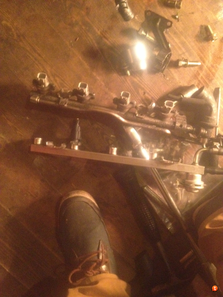

easy way is take the injectors off while the wirings all on and start it up and check if they all spray same, if they don't u know it's blocked on fuel lines or fuel pumpCool.. Next up is checking fuel lines!
further checks in the fuel pump or injectors will tell u moreI drove it home with a makeshift ether spray intake, basically a hose connected to the intake running through the firewall into the cabin with a can of ether at the other end. Felt a bit like macgyver. I haven't checked anything else yet..

I knew it was the fuel pump or injectors that can find the fault that's was the pump on mines tho and injector fuse wiresNO WONDER my car won't run properly when theres 4-5 liters of water (Or something other than petrol) in the tank..
First prime from fuel pump.
A bit hard to see the to phases, but IRL it was VERY visible!
I emptied as much as possible by using the fuel pump, and then fillede the whole tank with 0,5 liters of Carburettor Alcohol and petrol. Car runs much better now, although still choughing a bit as there still a bit of water left in the tank. I even have a good idea to why the water was in. The fuel hole and tube to the tank is rusty and ruptured, so water from the wheel can squirt up through the holes and run down the tank! Will defiantly buy a new one of those ASAP!
