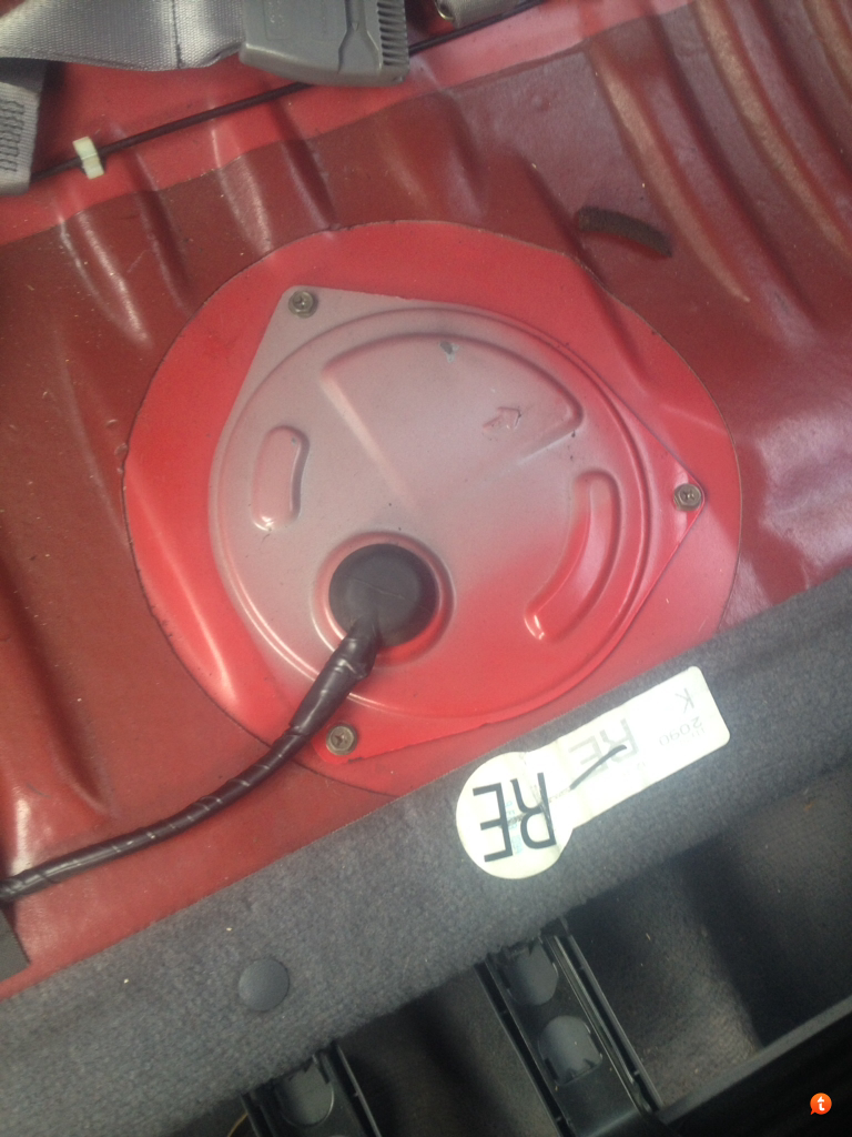

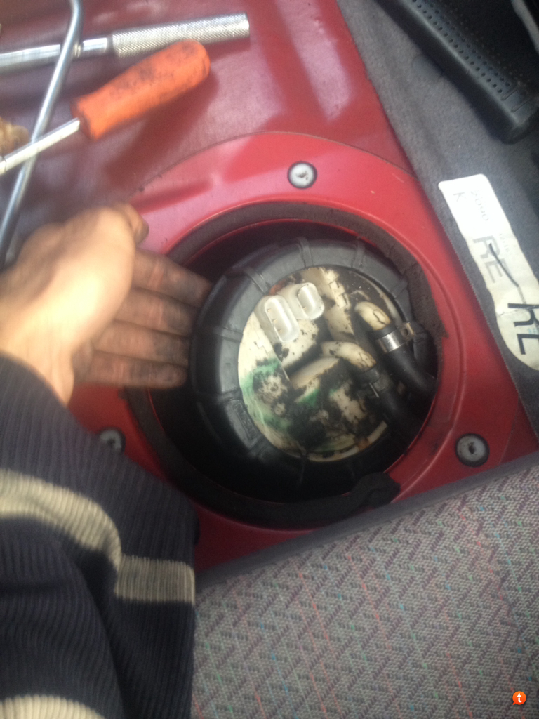

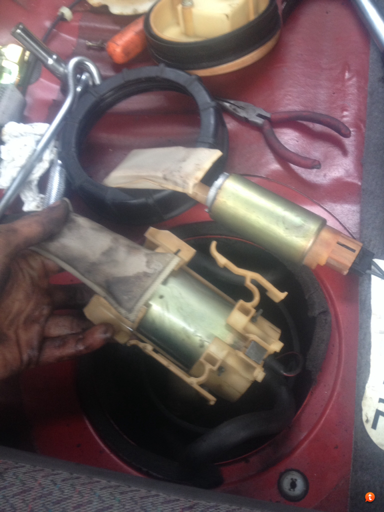

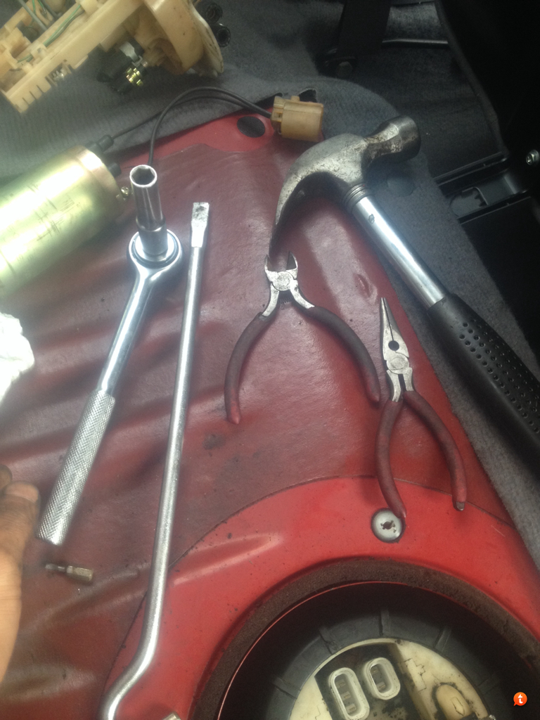

There is a little filter on the pump right?
no that's the engine breather on the rocker, it's in the rear seats like mines after changing it, it was all sorted
and that's tools I used only, took me 20 mins max easy check too maybe it's leaning your injectors

Have a check on fuel regular
the round but on the end can be blocked or bad fuel pump in the rear
