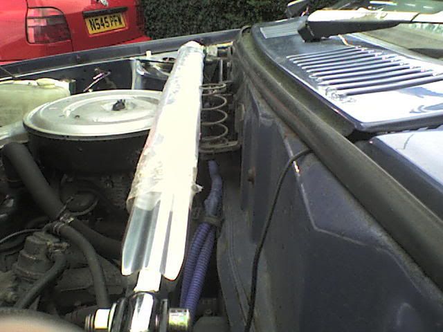

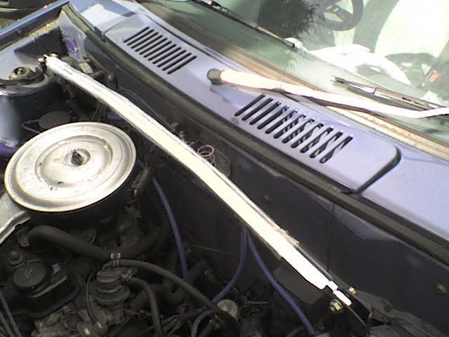

In a moment of crazy-bad boredom I bought an alloy corsa b strut brace with the hope it may fit the k10 as they are roughly the same size. Cost £40.
Got it through this morning and after taking some measurements everything seems to be as it should be. I'll try it on this weekend and get back to you.
This could be the end of ridiculously expensive figaro braces.
Goatboy fitted a nova strut to his, think it needed cutting down slightly, but fitted fine apart from that!
If it doesnt fit I'll modify or make up some new bits for the end. It looks like it goes up high enough. If all else fails I'll re-ebay it lol.
aye the nova and corsa braces do fit just require the mounting holes re-drilled to fit ;) few peeps did this many years ago
Haven't had a chance yet lol. Will try after I finish work (at 9).
I'll write a guide if any work needs doing to fit it.

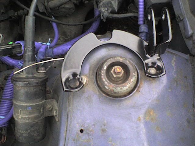

Not quite then, will have to make up some shiney new mounts:
the end bits bend em were the cut out is and then redrill to fit!

The reason i need new mounts is cos the old ones are too high and far back. It's only to look pretty anyway lol.
