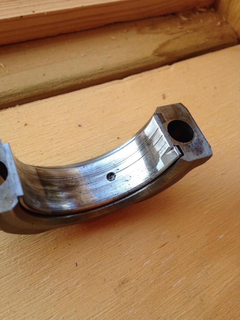

So today I finally got around to ripping the engine apart to see what caused the seizing.
All cylinders, pistons and rings are intact and as good as new.
Now when I was fitting the 1.0L pistons I put a small scratch in one of the conrod shell bearings. So I contacted Nissan and they sent me a replacement.
When it arrived I noticed that it had a hole in it and as the original ones don't have a hole I got back in touch with them to make sure it's the correct part. They checked and double checked and assured me that it was and that all Micra shell bearings now have a hole.

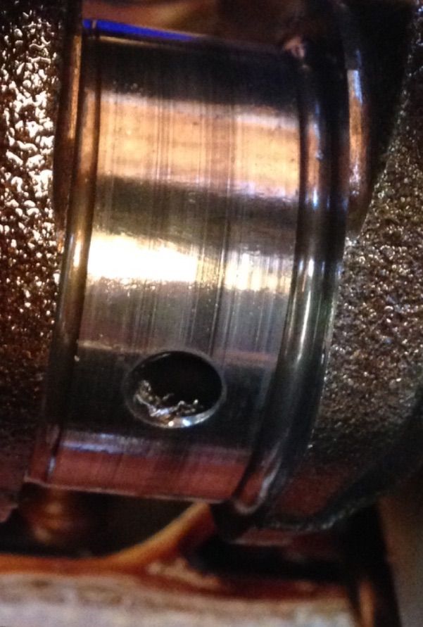

This is what I found when taking out the piston from the 2 cyclinders, the one with the replacement shell
As you can guess the crankshaft is equally fecked
you,re supposed to calculate the size/grade needed from the letter stampings on the crank and block, or else use plastigauge eh, i usually assemble the rods onto the bare crank, torque them up and check the clearance :)
i should have some shells you are welcome to wehey, have you tried cleaning up the crank journal ?
It's as shagged as the bearing mate so probably junk. I wouldn't want to risk using it as another disaster will finish me off lol
I would actually need 2 rod shells as the crank has chewed the other one up too
Would the shells be a match to skinner crank tho??
the shell surface is only soft white metal wehey, the journal might clean up ok ? and same scenario with paul,s crank eh, assess the running clearance and go from there (you need about 1" thou ideally)
if its white metal smeared onto the crankpin then it should clean up, but if it has scored the steel underneath then its toast eh :)
Very fine wet and dry 0r emery paper with plenty of oil maybe
aye, held in some sort of lapping tool, and a close watch on the colour patches of the 2 different metals :)
I have just had a go at cleaning it up and I think its toast. There are a few small pits and dings on the surface
