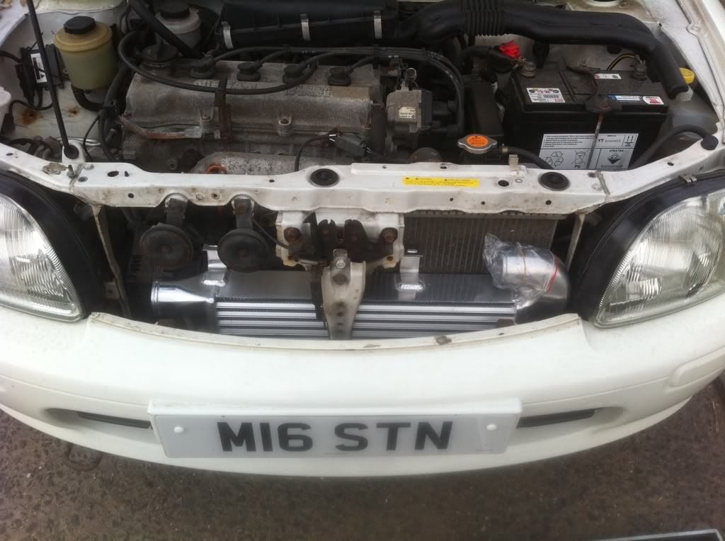

Just to complicate matters, my intercooler replaces the centre support bar and as a result actually became the support bar aswell the IC. :)
But you certainly cant complain with the clearance / fitment of stani's IC

Nah i just mean which way the manifold points, before i had the turbo at the top which gave me a long route of piping. If your looking at my intercooler, and a top mount turbo id recommend turning the radiator on its side
Yeah you can buying elbows and piping that size too. Or you can get an intercooler that the in and outs are at either end so you can run your piping like this

Yeah i'm hoping to do most the work myself but will ask for help from others when i need it. I'm looking to have the intercooler exactly how that is photo'd above ^^
Infact that is the exact set up i want! I can see from that photo that the intercooler sits on the cross member,as i was abit puzzled how/where it'd sit
Good stuff, its bolted in from underneath/through the crossmember eventhough the piping holds it tight. That intercooler was cheaper new :)
got a link by any chance? Did it come with the pipes or did you get them made seperately?

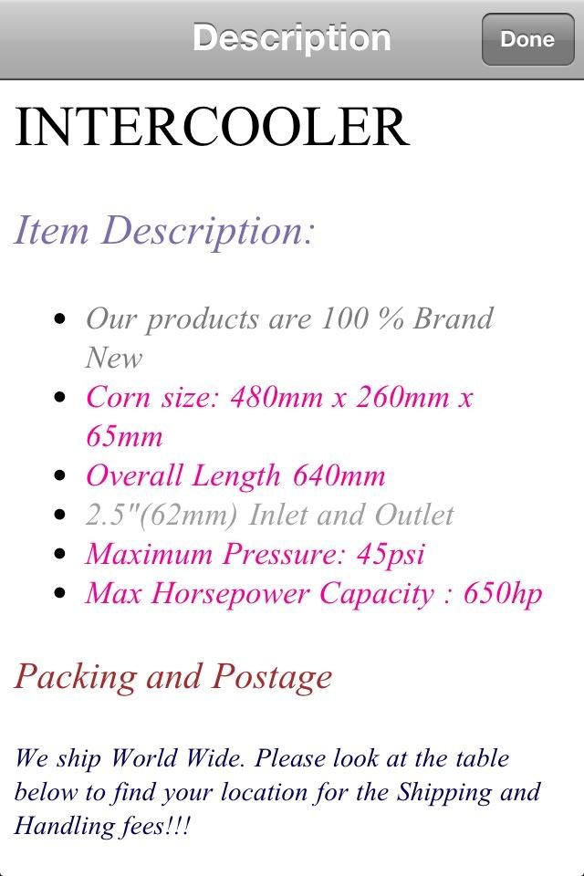

now buying the seperate bits and pieces for the intercooler,Stani when you said i'd need those for the bigger intercooler. Do you mean the narrow intercooler (your old one (2nd link)) or your current one?
My current one. The narrow one i think is 57mm OD but im not 100% sure so didnt put a link as i didnt want you buy something thats not going to work. Iirc the blue straight 2" couplers from the ic pipe kit fit over the ends at a push......
I'll wait till i've got the intercooler and measure it :) The flange,throttle body hose & the 2 different types of clamps are now ordered :)
Whats the 63-51 for? To use on the 57?
You should need 1x70-51mm elbow reducer for the throttle body, 2x57-51 straight reducers for the intercooler ends, and once you have your turbo measure the in and out on the inlet which most likely will take the 51mm hoses including in tge piping kit :)
