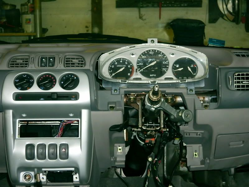

as was I but lets not argue over spilt milk eh! changeover is progressing interia is almost out just waiting for peter to bring sockets over to remove steering wheel airbag unit then I will be removing wireing thing I noticed when under bonnett is that the wiper motor will need changing as the plugs arnt the same just another little set back but as im not that far into yet there is no need to worry will be posting some pics later....
interia out looms on there way out progressing nicely........
