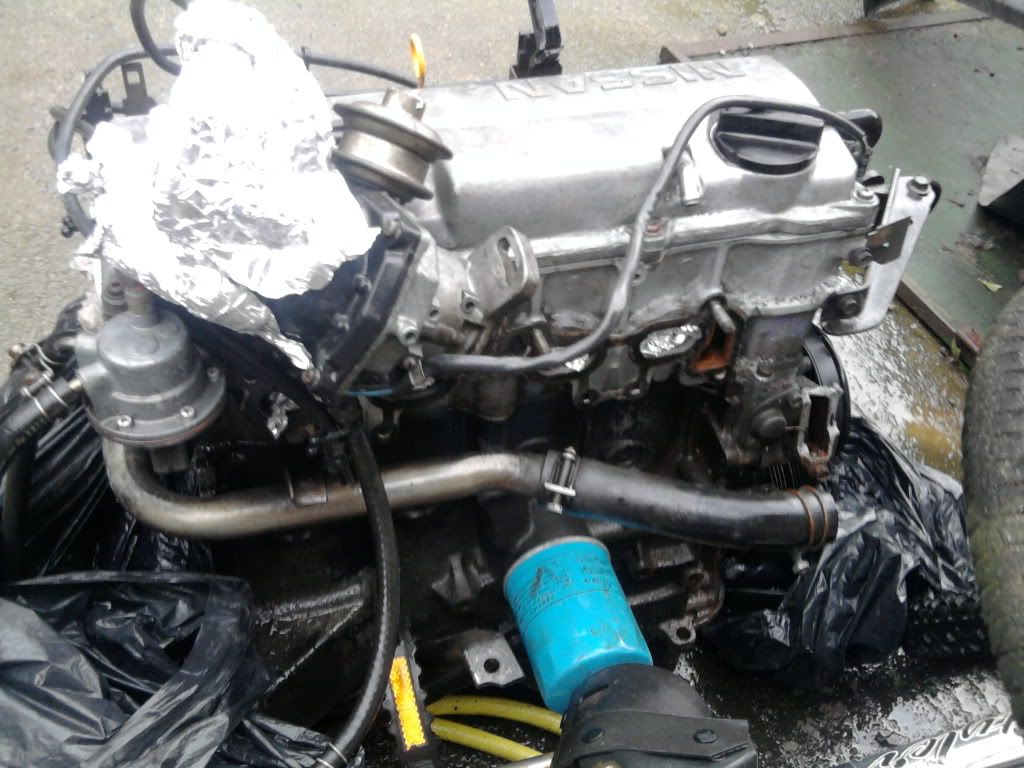

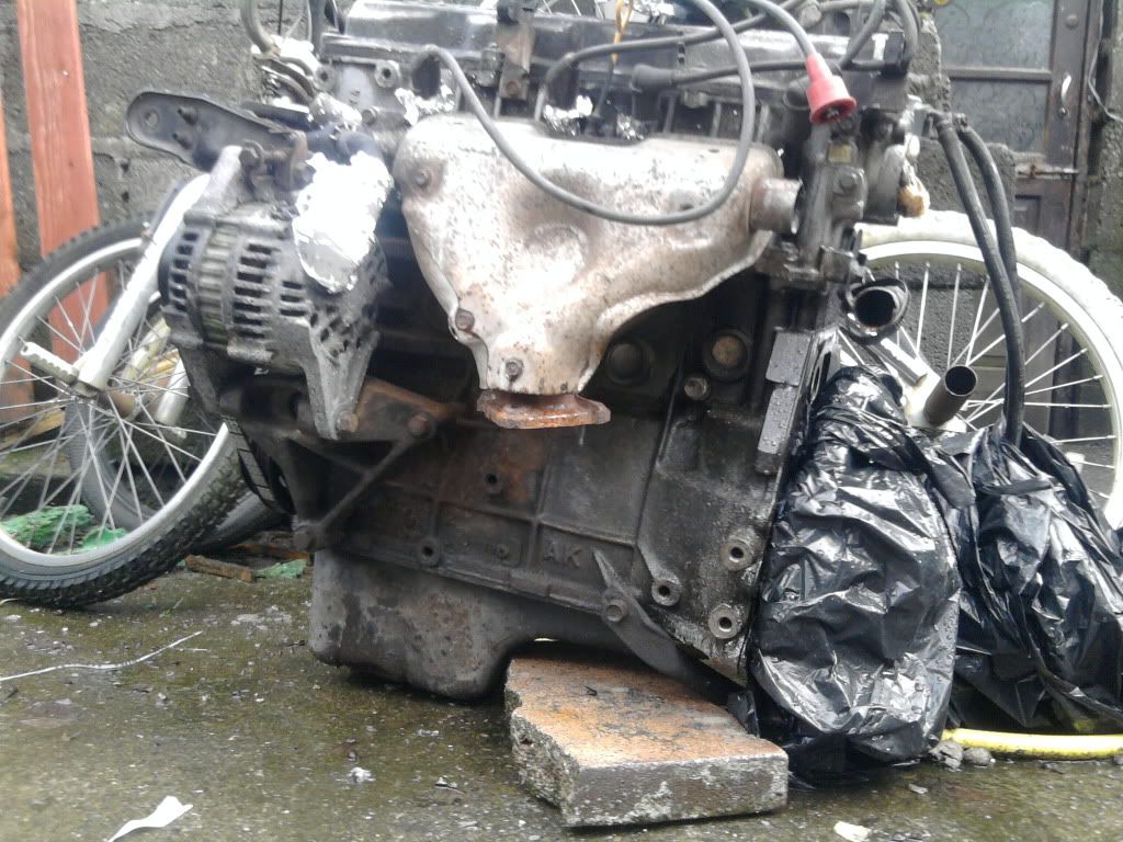

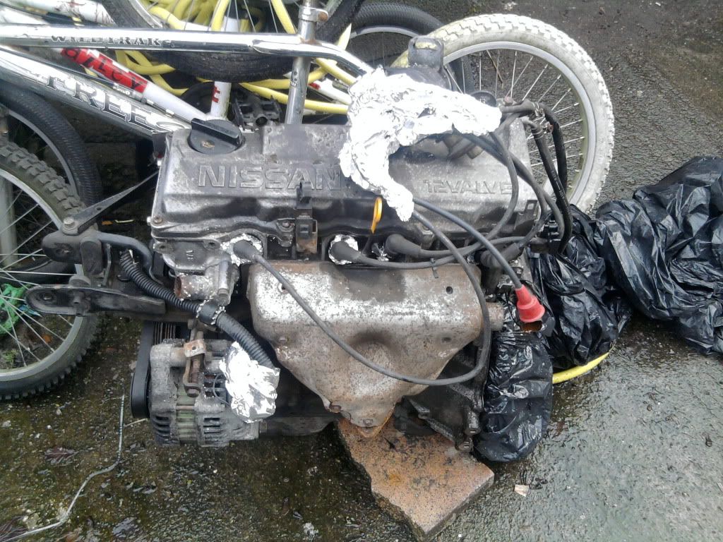

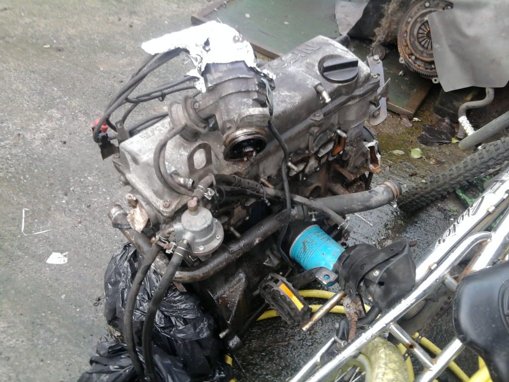

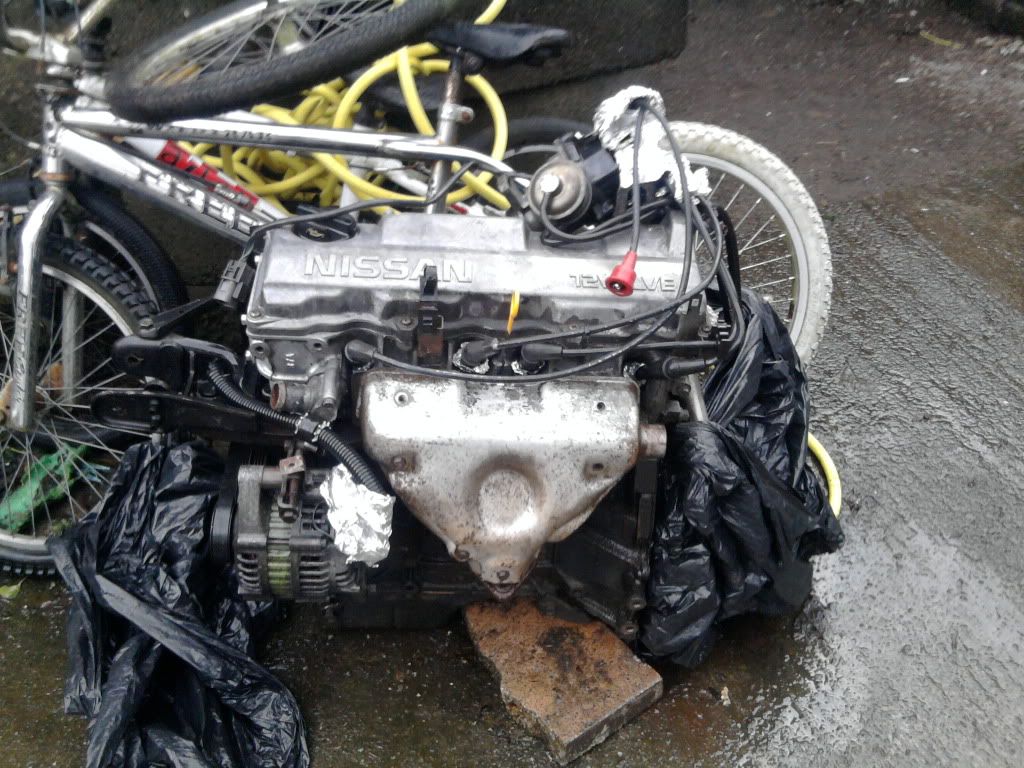

got the sunny engine 2day :)
inlet mani is completly different and the dizzy :(
any1 have an idea wat way i would wire the dizzy it has 4 wires on it unlike 2 on the k10
tout it my be an easy fit if the k10 mani and dizzy fit on less work lol ders alot more to the sunny carb need to have a proper look at it weather is holding me bak and skul den wen am bak 4rm skul its f***ing dark :( engine mounts do seem easy to work with :) need time and weather just
ok the mani and dizzy are complety different than the k10 and on the dizzy there is 4 wires unlike 2 on the k10

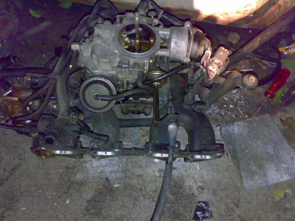

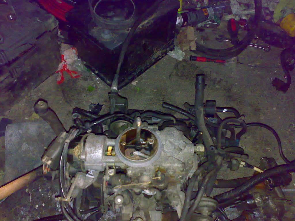

that carb looks ecc controller from here, id steer clear of it, best theing to do would be to make an alu adapter plate to put the k10 carb on the 1.4 inlet. if the carb is ecc controlled then the dizzy will be no good, so then id look at fitting a k10 one, you may have to get an adapter plate and collar made for it tho.
have you got the gearbox too? are you going to see if the k10 gearbox will fit it?
superls,,
tbh im not familiar with ecc..i rely need to look into it more il get a pic of the mani on its own so you can see

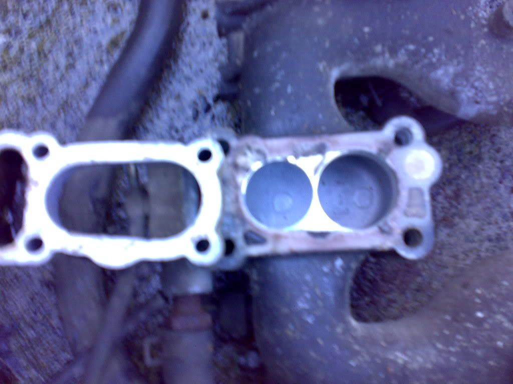

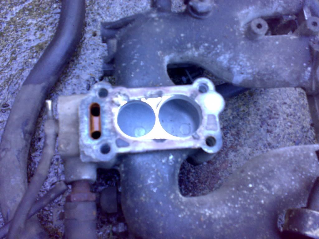

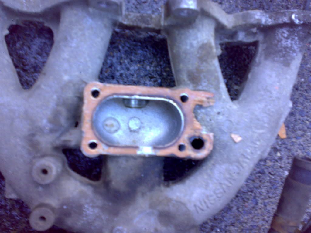

I measured the difference between the sunny and micra manifold
there is a spacer between the micra carb and mani which I think could be fitted on the sunny carb wit some work or make a new flange to fit it
But would the micra carb give enough fuel and air for the 1.4 engine and if not would drilling out the petrol jets work??
and there is a place for water in both manifolds is dat just for the auto choke??
cheers:D!!
The sunny manifold
The micra manifold
The spacer and sunny mani
the difference is tiny theres only a few mm between the bolt holes
Swap the sunny jets into the micra carb and use the micra carb. Drill the holes on the sunny manifold a bit bigger so they line up with the micra spacer then use a micra gasket and it should work nicely.

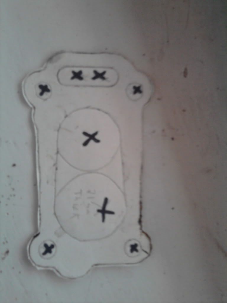

Sorry for no update for the last while I have made no progress as I have my leaving cert mock exams in February and am very caught up with school il have a plate made for the carb hopefully before march
