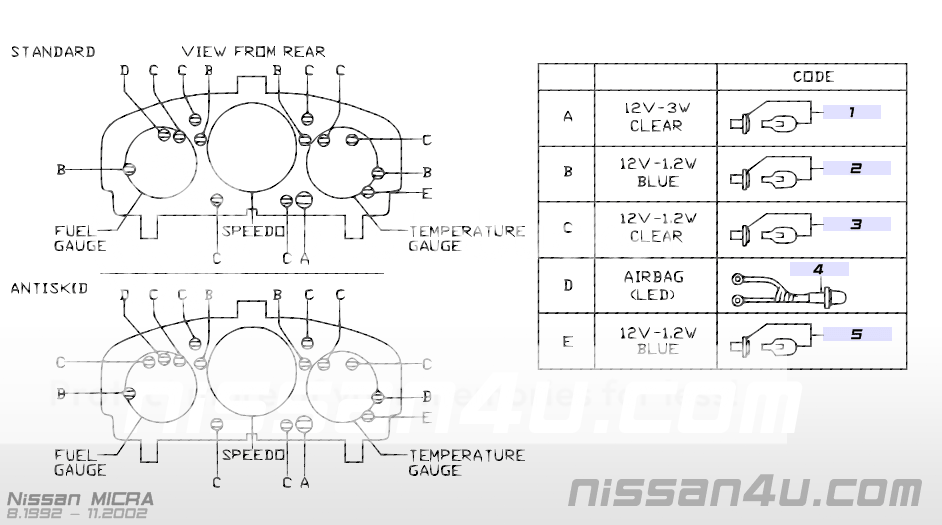

this is proberly a stupid question but i have to ask.
i brought some t5 286 led bulbs to brighten up my speedo there UV purple
however i dont know what bulbs are what
i have 10 bulbs so what ones are what and will they all take this size bulb?
i assume the indicators and warning lights have colored film over them so it would be pointless to change i would just like the 3 dials to be lit
any help would be great as im confused
