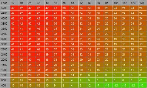

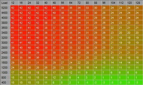

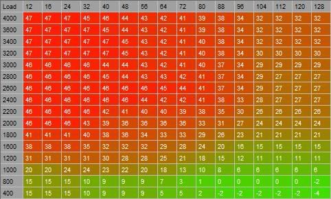

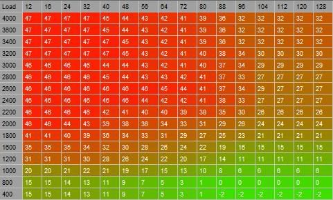

Ignition Maps
1.0 Facelift:
1.0 Pre-Facelift:
1.3 Facelift:
1.3 Pre-Facelift:
Regards (Y)
Thanks mate!
can i ask where you got those maps from? it is different from the one i have got at the moment which is supposed to be 'stock'
edit: just realised that i was looking at the facelift map, its not all that different from the one that i have at the moment.
Thanks mate!
I download those maps from the different Micra ECU's using Consult Cable... Every Micra owner should have a Consult Cable.
If you need any other info about Micra ECU maps tell me something.
