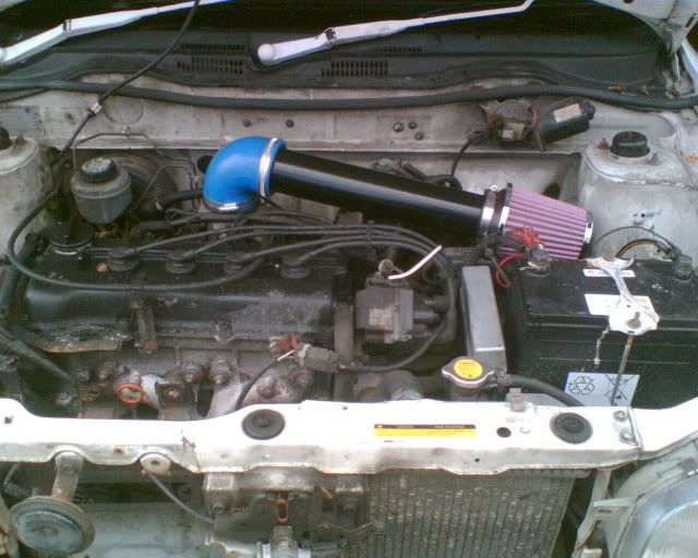

My kits finished, and here it is:
I'd've liked to have taken it to the drivers side and put the filter directly behind the light, but no such luck.
ive just finished doing mine, need 2 get a decent intake flow tho but its up behind the battery now and not directly behind the engine
here is mine, yes i know it needs a clean so dont comment on it lol
