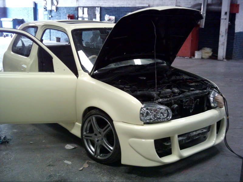

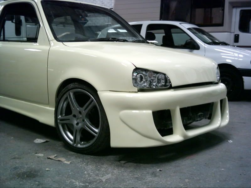

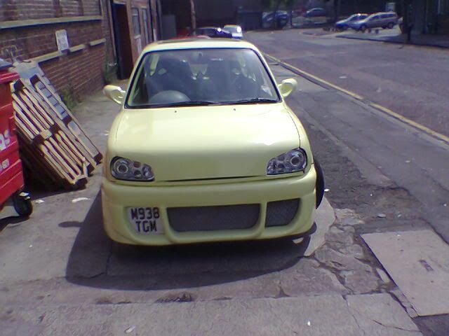

yeah they are mk4 golf angel eye projector headlights...

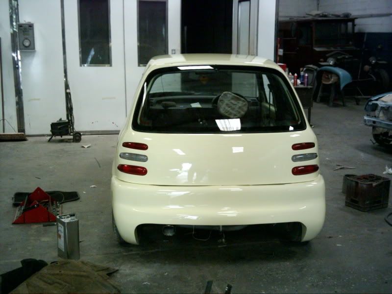

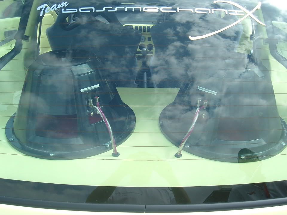

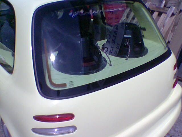

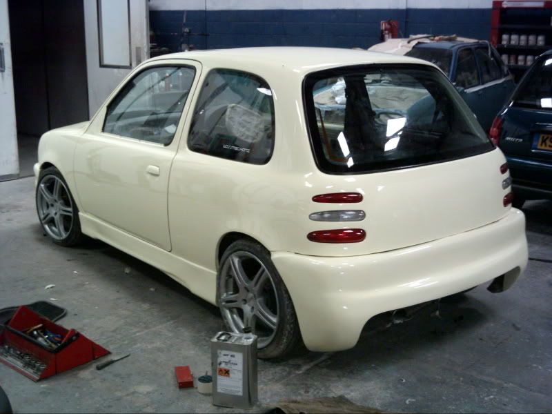

looked into making the rear window open like a tailgate but 1. you cant drilll the
glass as it will just shatter due to it being toughened, 2. i almost got a window
made from a type of plastic but i really couldnt be bothered with the hassle
of making a locking and sealing mechanism!! 3. due to the bass, having a hinged
window would be pointless because it would just rattle to hell!!

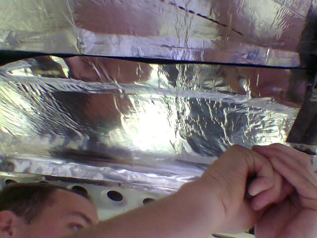

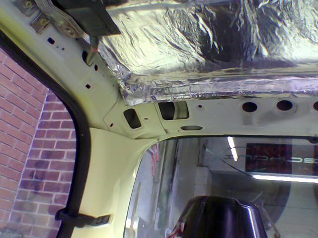

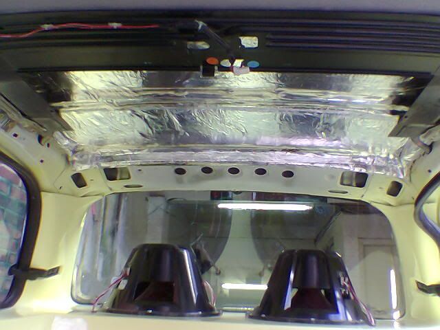

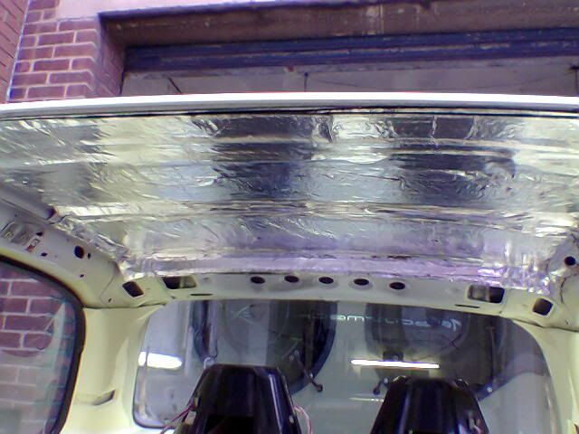

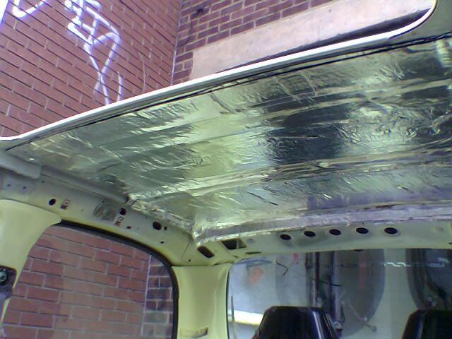

yeah the car is taking some stress off the install, the rear hatch and rear 3/4s have been
dynamatted, i am fingers crossed doin the roof and doors this week, 3 layers on the
roof 2 in the doors....
ill get a video up of how much the roof flexes at the minute...its crazy!!

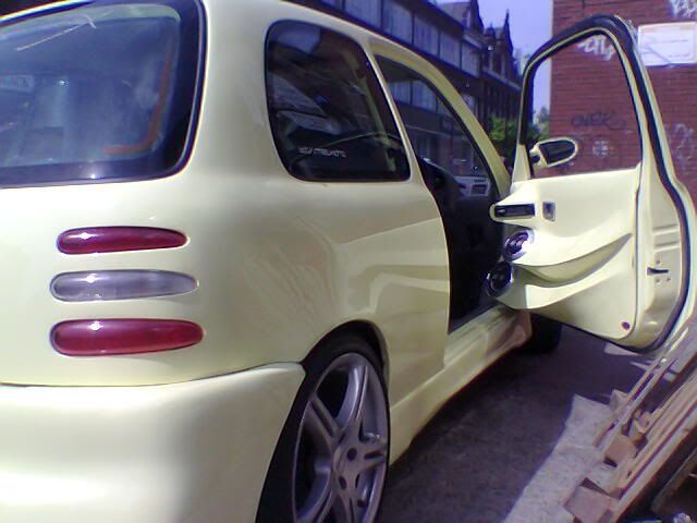

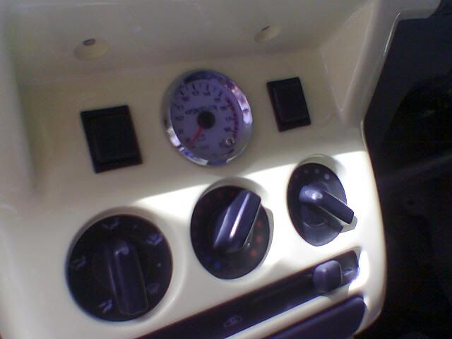

headunit in door-im chuffed with this, i just mentioned it one day in bassmechanix and they
were like, "wey aye we'll give that a go!!". the actual headunit is still in the centre console
(hidden behind a panel), a multi core computer cable was then soldered onto each little
terminal which connects the headunit to the facia and ran into the door card where it was
soldered to the facia!! big up snoop for this time consuming and fiddly job.
there is a connector in the door card which allows the facia to be disconnected so the
door card can come off.
