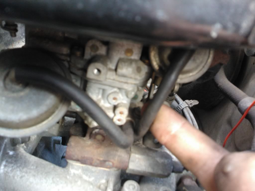

im guna ask, whats an anti dieseling valve for lol?clear as mud adam the one below your finger is the anti dieseling valve eh
thats the autochoke mech ehnot bad it sometimes starts then dies but i read in the owners hand bookk that if it does that to press the throttle pedal once then release and start it and i find it starts every time if i do that
Thinks it stops the engine 'running on' when you turn off. I'll check in manual shortlyim guna ask, whats an anti dieseling valve for lol?
to stop it "dieseling" (running on)im guna ask, whats an anti dieseling valve for lol?
As frank says, you have to press the throttle pedal to 'set' the autochoke prior to starting. It will rev quite high at first, after a few seconds blip the throttle and the revs will dropnot bad it sometimes starts then dies but i read in the owners hand bookk that if it does that to press the throttle pedal once then release and start it and i find it starts every time if i do that
ah i see ,thats the autochoke mech eh
