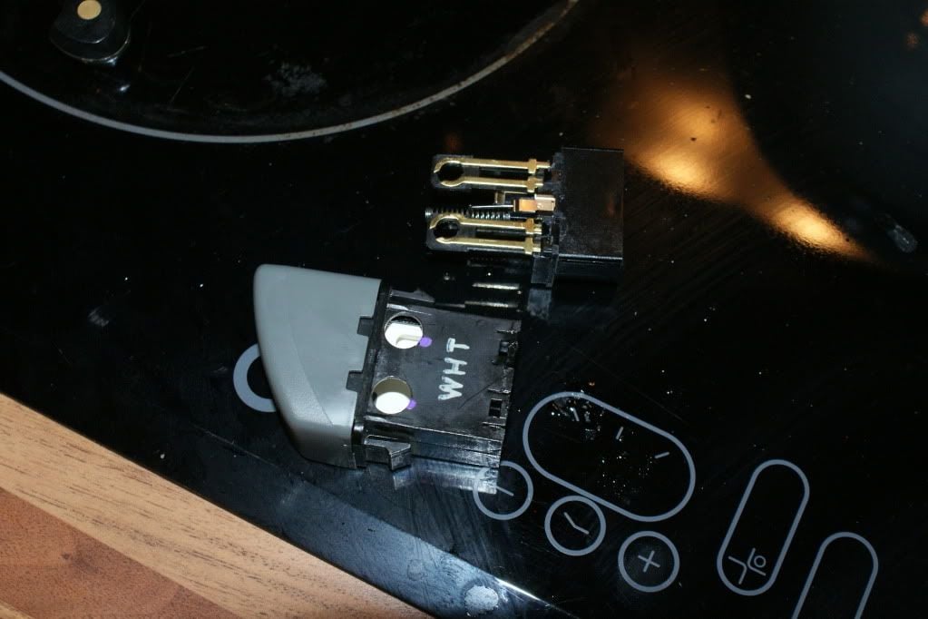

ok took the switch out of the car and gently took the switch apart. you can replace the bulb without taking the switch apart as there is a small plug with a small bulb attached to it. i presume you can just buy a replacement at Nissan or i know for definate that you can buy just the replacement bulb as i used the exact same type on the Shogun....but i am putting in a larger brighter bulb in, just looking for the soldering iron, PLUS the missus has just took the car out shopping so i had to put the switch quickly back in as the indicators dont work with it out. :laugh:
ok...done both switches!
took them apart, you can see on the photos where the small bulb touches.
I resoldered a bright white LED onto it and carefully put the switch back together.

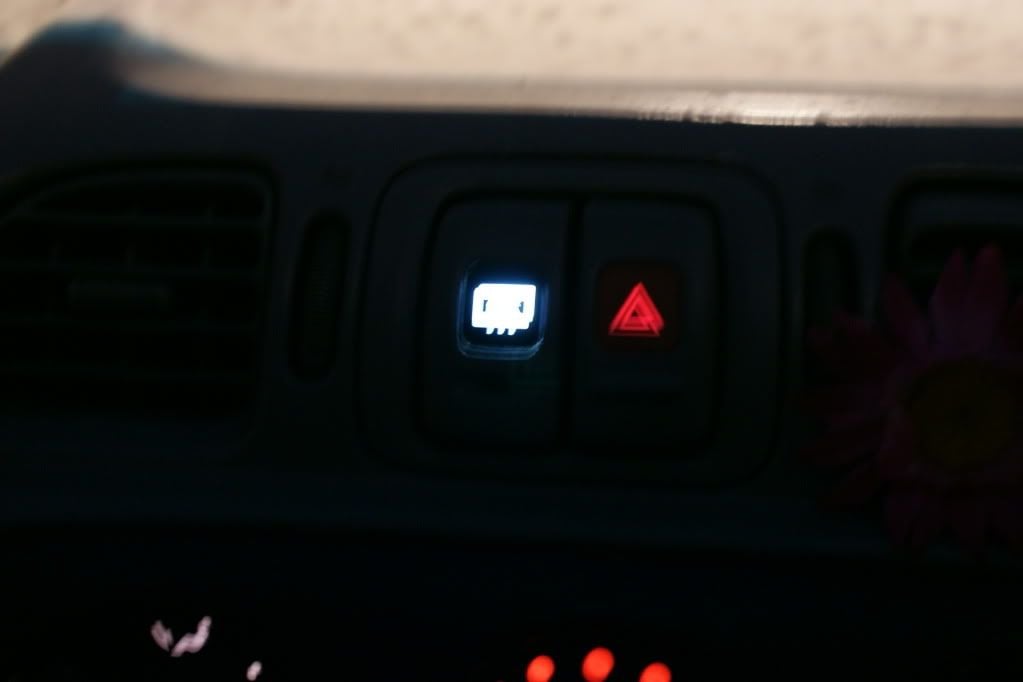

The heated rear screen switch is a very bright clean white and now the hazard switch lights up as well, although not as bright as there is a red filter in there.

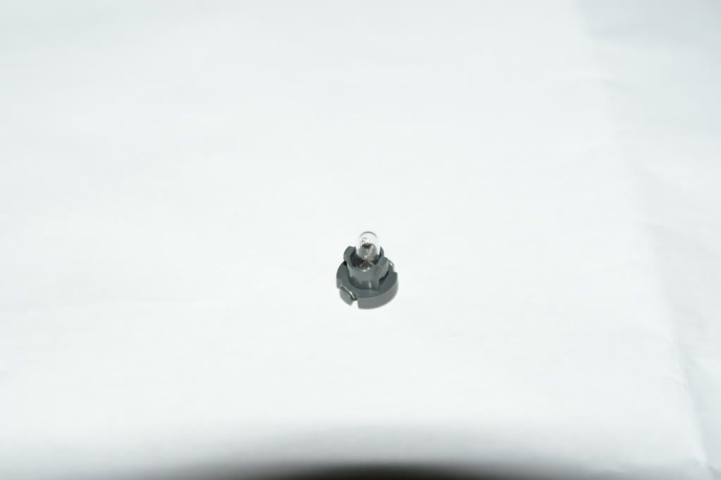

here is a picture of the original bulb i replaced.
any opinions?

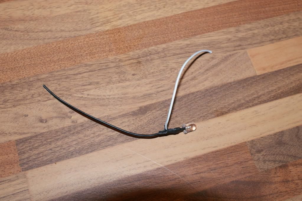

I've got the switch out but can't find a bulb small enough to fit. I'll probably have to use a small led - leeandjude, where did you get your led bulb? also, how did you fit it? have seen some small leds on ebay but there is a resistor soldered into the wire - looking at your picture, your wire also has this. where did you put this as it will have to fit back into the surround when finished.
I didnt really buy these led's to use in switches as they were for something else.
but heres the link: http://cgi.ebay.co.uk/5-x-Pre-wired...al_Components_Supplies_ET?hash=item53dbf1a807
I first found out which contact does the main light (not the switch on light), I then soldered it on after cutting it to the right length. The led i fed through the switch holes to the front. You have to be careful putting the switch back together otherwise it wont work.

Not sure about yours, but doing mine today (nowish) - you don't even need to take the thing apart. There's a quarter-turn thing that holds the bulb that comes out. Looks like a "grain of wheat" bulb (a.k.a. T1). There are quite a few on ebay, no soldering needed ;) (in theory. Waiting on my bulbs to arrive)
