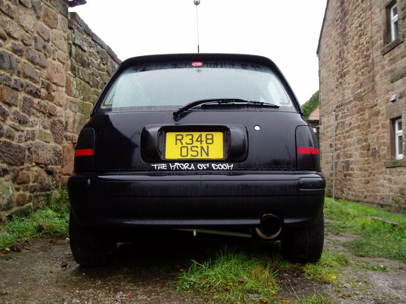

yearh...ive been to motor factors and orded a tin that will come tomorrow, so should have them done for the weekend...iam leaving the reflector un-smoked so they are leagl, dont fancie tinting it and the hasstle of swapping lights come MOT. also sanded the letters off the plastic so they are smooth :p
just make sure the reflectors show through the tint, and the lights! ive just masked my reflector off and tinted the rest...
the k12 is very different as the reflector is on the outside all the way round unless you get lexus light then the reflector is on the indicator lol
the reflectors on the k11 facelifts lights are on around the otside of one of the bubbles so you would have to tint the whole light as it would look odd imo, plus would be a nightmare to mask off! hence why i used prefcaelift lights, as the reflector is in a strip and it easy to mask...also they look smoother as they dont have the bubbles like my standard facelift ones :)

yearh its just a thin strip...
yer, but you dont need to mask the whole lot off, i only masked a little bit of my reflector when i did it and its still legal.
right ok so i could mask off a smaller section ill post a pic up of what i mean
infact ive been dumb lol just checked moddeds pic cheers really helped me out here!
