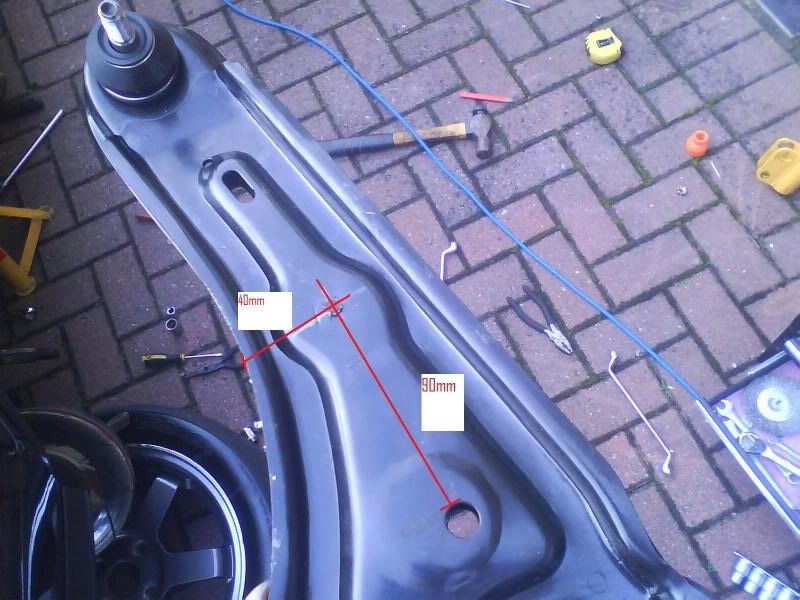

1.Use the measurements on the old LCA to select the correct drill bit fot the anti-roll bar link hole
2.Use the measurement in the photo to get the correct markings
3.I used a punch on the center line to make sure the hole to be drilled was center.

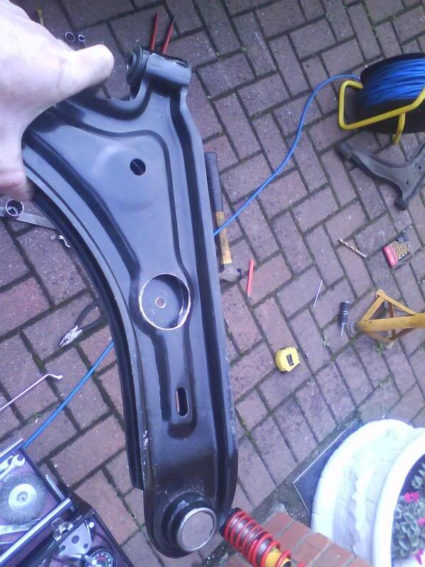

4. Drill a 3mm pilot hole straight through the LCA ,now you have to holes.one on the top and bottom of the the LCA.
5.Turn the LCA over and use an 1 1/4" HSS core cutter to cut out the bottom layer of the LCA for the link to sit into. Be careful not to damage the second layer of metal.
6.I used black touch up on the cut metal to prevent rust

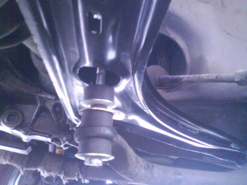

This should then look like this. . .
Fitting is basically reverse of removal
And as you can see in this crappy phone pic the link is perfect
Car feels excellent now. Hope this helps Lads(Y)(Y)
