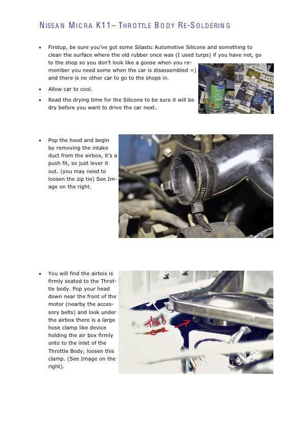

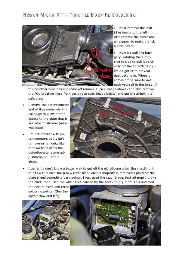

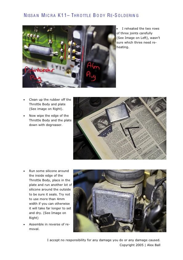

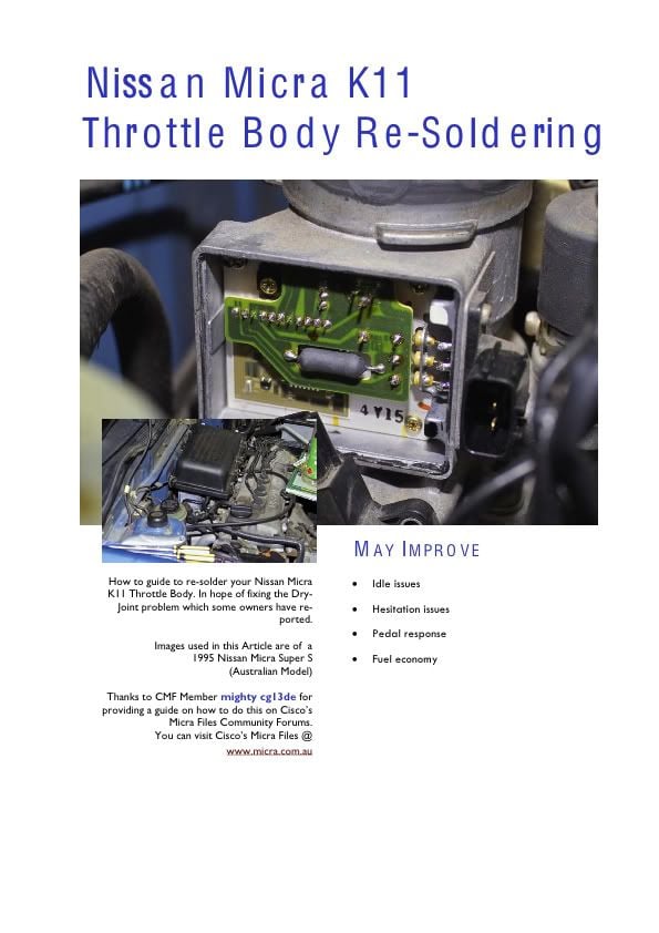

solder joints at throttle bodie-famous resoldering guide stone somewhere
or maybe the connector plug that goes on the throttle body needs a wigle and a jiggle
Shaun had the hesitation through gears and he seems to have solved the problem by soldering the joints on the MAF.
Could someone explain to me where this MAF connection is....and how and what do I re-solder.
(I noticed a link on another thread, but it wouldnt alow me to open it)
Thanks.
hope it helps. this is the guide converted to pics
WE USED TO DO THIS BACK IN ABOUT 1996. IT WORKS WELL. BOUGHT A FEW TRADE INS IN THE PAST ON THE CHEAP UNDER THE PRETENSE OF THE MAFS BEING 400 QUID ODD. DEALER PRINCIPALS NOT BOTHERED TO LET CAR GO TO US MECHANICS WHEN THEY CUT OUT ALL THE TIME HEHE:laugh:
Cheers peeps...... i may get a look at it this afternoon, want to check the lamda values first tho......I will feedback my findings...
Sadly it didnt work..... however an interesting little task, which went well when following the above procedure.

I resoldered them by reheating then adding more solder. simples.
Open end spanner for the lambda unless you wanna hunt down that cut open tool
im guessing its easier to do it out the car? lol its funny tho as at the end of the day your not actually do much to it
Yeah take it out of the car i wouldn't risk soldering electrical components whilst it's still on there, besides it would be awkward.
5 mins to get it out 1 min to solder, can have it running again within 10mins.
