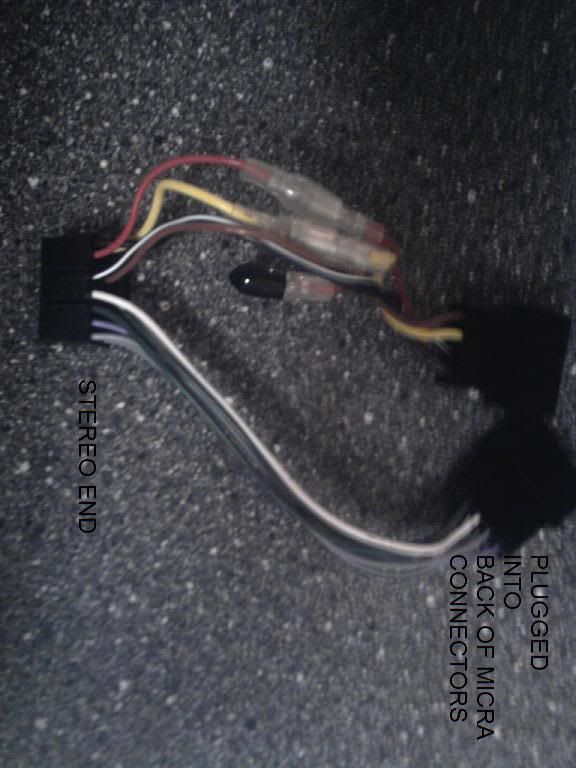

hello i switched from my p reg vibe today to my l reg lx and i want to change the stereo over. i got the factory fitted one out the lx and went to plug my one from the vibe into the lx. problem is its not a direct plug and play. the thing is with the vibe the connector i got with the stereo clipped straight onto the ones in the back of the vibe. with the lx it isnt the same the connector appears to be older.
is there a way i can buy an adaptor or something so i dont have to go snipping wires and mix n matching.
this is the connector that came with the stereo that plugged straight onto the connectors in the vibe and into my stereo.

DizzySpell you see in the bottom picture you have there. there is a wire with that small round hoop. what is it for? i cant see what i need to connect it to and my stereo isnt work so maybe thats the cause, either that or maybe the fuse.
Yeah it will. Connect to a screw on the metal cage I think. Im no electrical expert though so maybe elsewhere?
ok so screw the earth to the cage and all should be well, if not ill try the fuse.
thanks again
no, the cage is,nt earthed iirc, you have to earth to the chassis (there,s a brace/bracket either side of the middle dash section)
thanks for the help guys screwed in the earth and all was well.
i think it helps to have the aerial in as well not sure if it makes a difference but worth trying to anyone who has had trouble.
