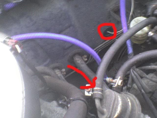

The hardest part I usually find is getting the cable from the battery to the amp. You need to find a rubber grommit in the engine bay leading to the passenger footwell

Here is a picture of where to put the power wire through. It is circled in red. The arrow points to the fuel pump as a reference point for you. Hope it helps:
