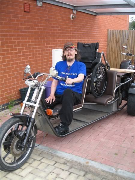

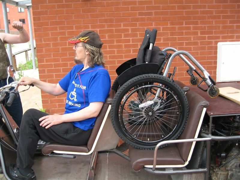

Hiya, here goes then... I broke my back a few years ago and use a wheelchair, hence the need for an autobox, so I can ride it with handlebar mounted controls.
There you go....gives you some idea of whats going on... :)

hi bazza nice trike and the over heating prob may be the seat is restricting a good air flow in to the radiator
Thanks...Yep, for sure, its not in a good position and I think the damage is done now. I have another rad and fan which I will be fitting as well as the original for the new motor, to help...
Bazza
ok i see looking closer to the pics if there was a open section on the plate under the seat you should get the air flow needed and if u mount to rads you could do this te other side to keep it looking good
