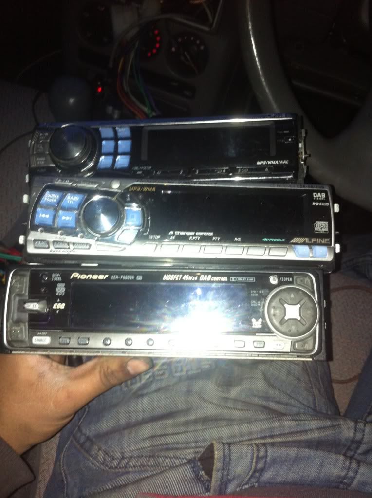

Tried everything guys it just doesnt store memory at all and just to confirm it aint the stereo iv tried 2 other ones today..just plain confused now :s
did you follow the wire colours i said about? also you can check the radio to see what it needs for memory as some have been known to swap about , simply switch on ignition plug both lives in so radio comes on , then take one wire off at a time to see which one keeps memory when radio is off and switched back on some times a clock will show up when its on memory with ignition off
