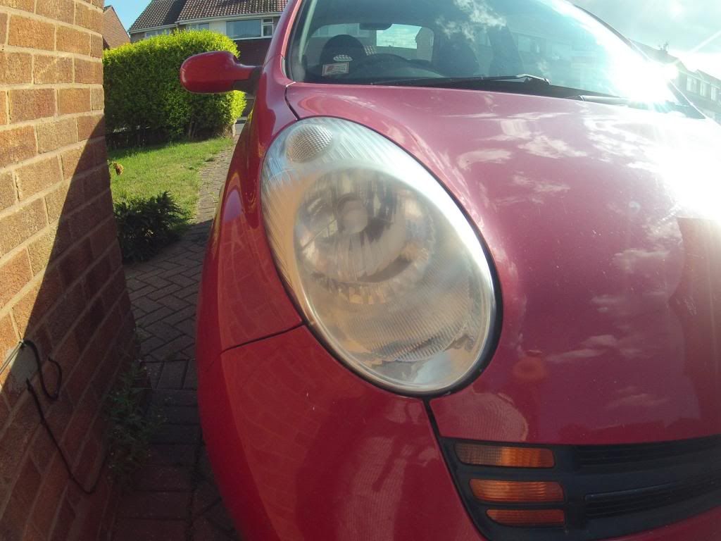

A before of the passengers light (the worst of the two..)

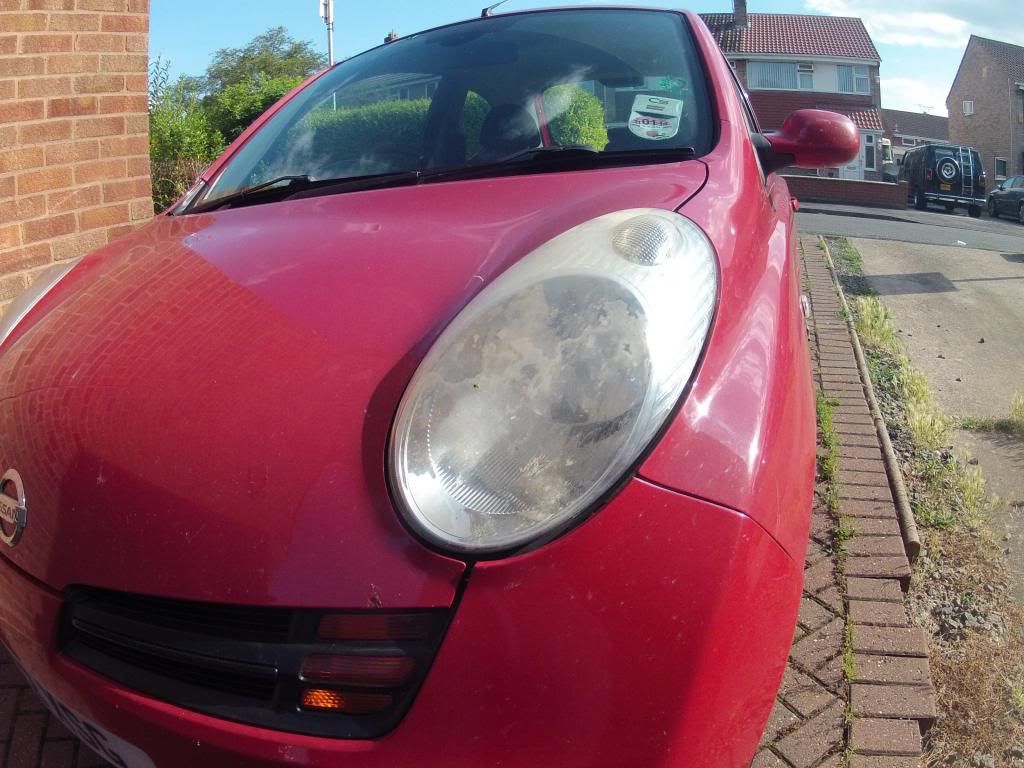

(Also showing some faded red paint to rival a Trophy's...)
And the drivers side (better, because I had a go at this one before but ran out of f***s to give..)

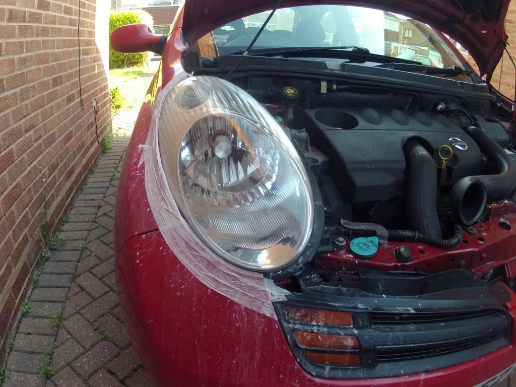

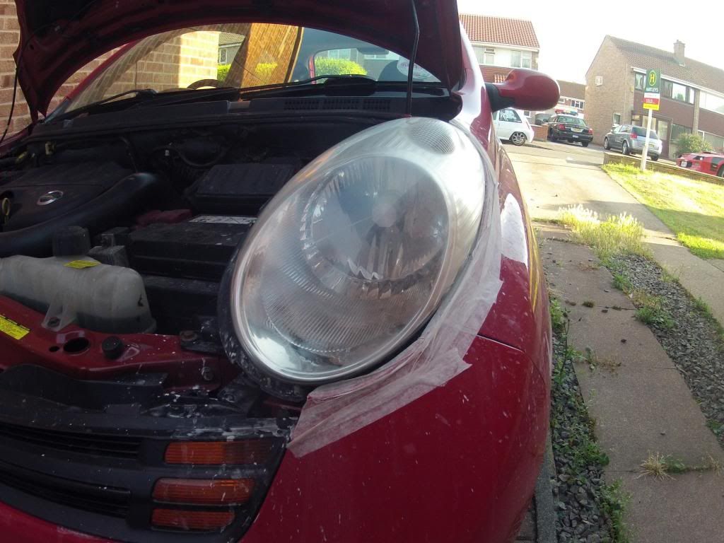

Some durings...
(yes, that is masking tape, yes it was a bi*ch to get off in one piece, and no, I didn't do it with the bonnet closed - I had to nip out to get the Meguiars... got some funny looks!)

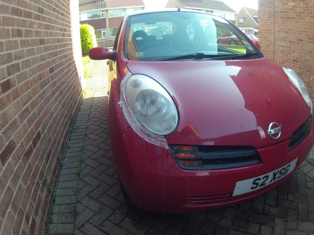

And finally, the only after i got, but a visible improvement. I've also whipped the indicators/grille out and gave it a dusting over with some satin paint (will get photos when its all back together)
At least now the front looks average, shame the rest is a couple of shades of pink/dirt (any volunteers...?)
