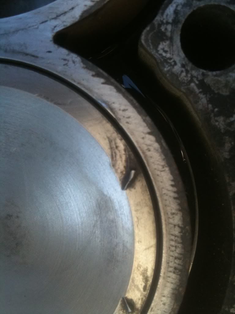

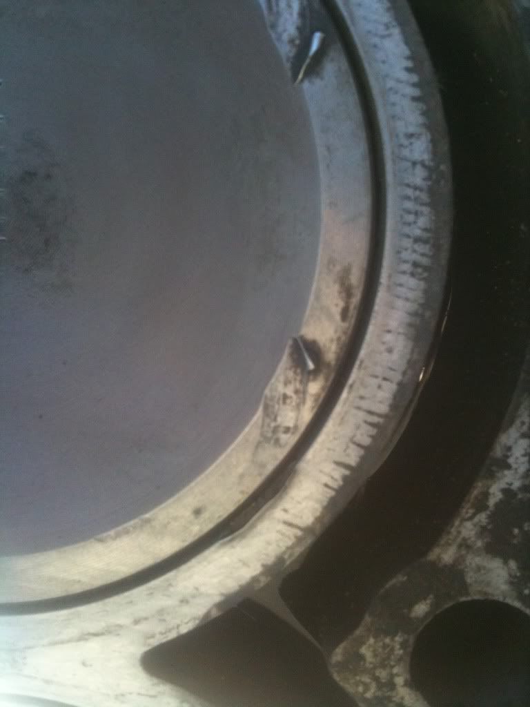

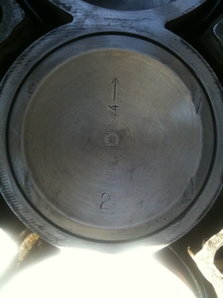

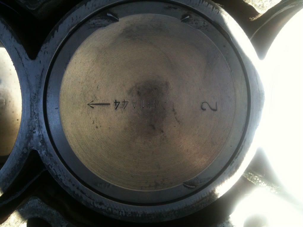

Pistons 1 3 and 4 looks fine (with a very VERY faint mark from vavles) but this is how piston 2 looked:
close up:
I managed to work them out a little bit:

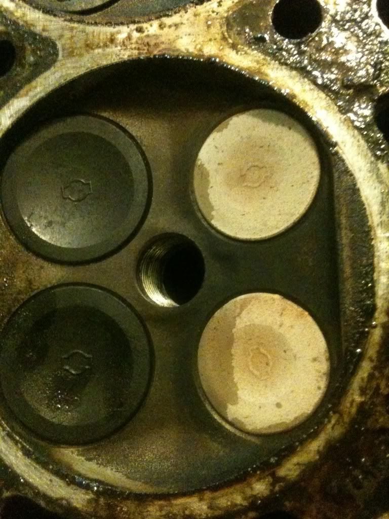

Looking at the underside of the head (valves) i found that the cylinder two vavles were discoloured. Although dont look burned of damaged, more like they were replaced?
Is it possible that this engine had a snapped timing chain(causing the damage) and the person who replaced it didnt do a good job (misfiring).

either valvebounce (over-revved) or wrong valve timing imo, and you can bet the valves on # 2 are bent eh :eek:
i usually straighten the valves with a penny under the contact side (but i,m pretty ghetto lol) fit another head maybe ?
Theres are the vavles from #2:

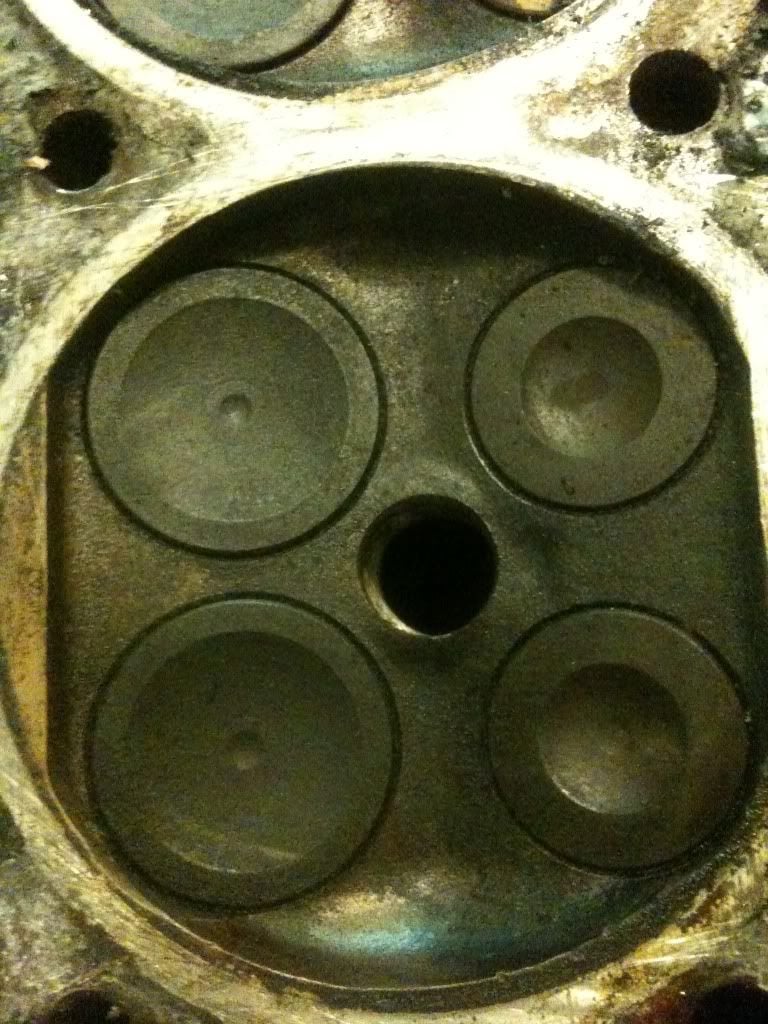

and this is how th rest look:
None of the vavle seem like they are bent though
Also you can see the rest of the vavles have a nissan logo (or something) while #2 doesnt
it looks like they,ve been replaced (but not "ground in" tho maybe) :eek:
i usually test the seal by filling the chamber with soapy water and blowing up the ports with an airline
The engine definately had work done on it, the valves from Cyl #2 are not Nissan valves, so have been replaced by someone along the way through a random garage.
