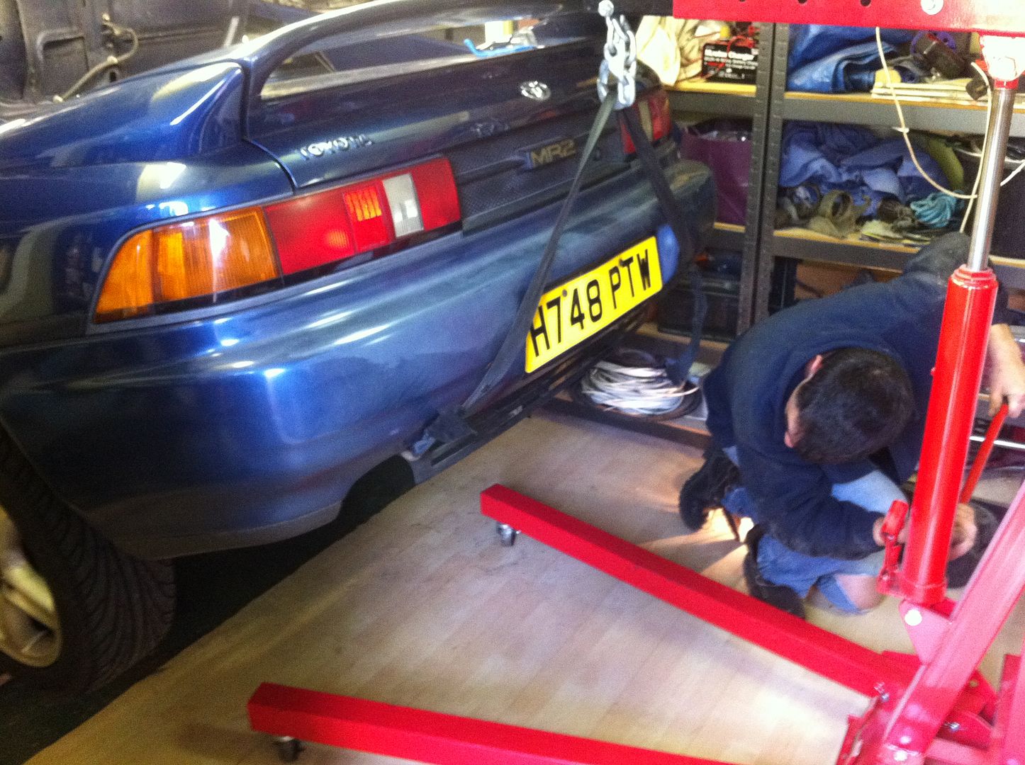

I got my engine crane from sgs engineering. Very well made, and then I resold it on ebay. It ended up cheaper than hiring one and I wasn't under any time constraints.
^ Very much this. I bought a £120 eBay crane about 5 years ago on the basis that I could use it, resell it and save money on hiring. Since then its done at least a dozen Mr2 engine swaps and been used to lift cars of all sorts.
