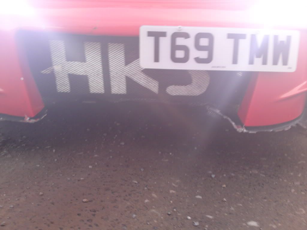

hey all, bad news unfortunately i broke my front splitter while parking
the middle piece came of and i dont know how to get it sorted coz i dont have all the pieces.
[/IMG]
only way i think it could be done is bumper off then get a piece of mdf wrapped in cling film. Place bumper on it and cut out shape of splitter the make a fibre glass mould of this then fill sand prime paint etc. Though that could be just stupid lol :p
or as you say remove the splitter then make a bottom bit for the bumper.

Sorry to see the damage waz, will take some repairing to get that back to rights!

you should be able to get some fibreglass from halfords etc. and fix it, either that or trim the splitter away so your left with just the bumper.
I'm with decxter, copy shape onto a sheet of cardboard or plywood, then use this as a template to repair in fibreglass.

i have an idea mate if you dont want that splitter, cut it completely off and get a laguna or polo splitter, and then retro fit it and i think it would give a good base to the hks bit as it would be left plain right?
