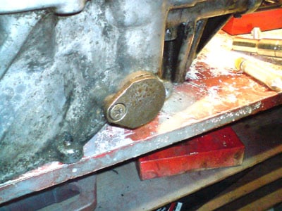

look at bottom of this post on me blog
2010-09-376-jpg.33591
http://micra.org.uk/threads/pollymobiles-rebuild.35251/page-11#post-419891

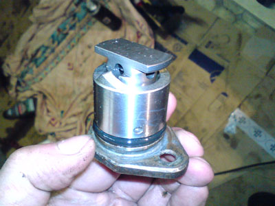

I have taken the offending part out. It put up a fight esp as I was laying under the car in a puddle.
When I removed it a small ball bearing fell out too.
Any idea where it goes. It doesn't seem to be part of the mechanism?
Lookes like a load of crud has got inside the assembly and caused it to stick.
Have freed it up now and ready to reinstall.
Just got to figure out where this extra ball bearing has come from first
