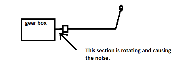

When the car is in neutral and you put the gear stick from side to side it makes a clunking noise.
I have had a look and the noise is made where the gear linkage goes into the gearbox.
I drew a pic to help yous understand it. :blush:
Anyone any idea what it is? also its hard to get into 3rd gear.
Cheers
