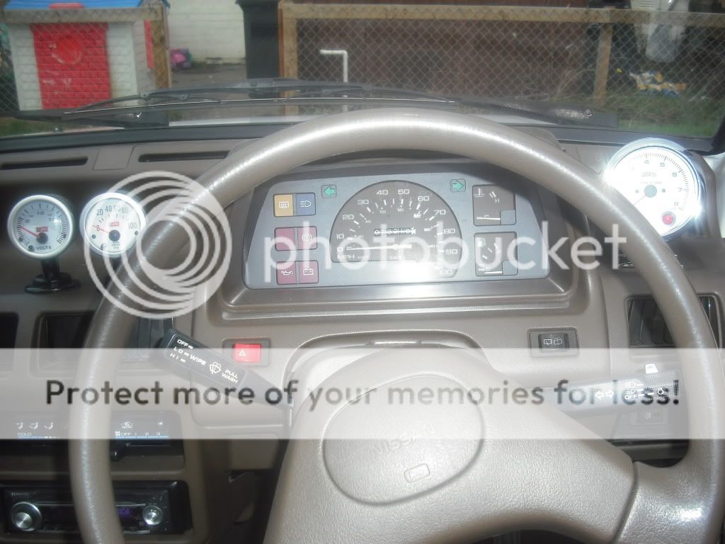

The gauge comes with an electrical sender unit. Unscrew the original oil light sender from the engine and screw in the new sender for the gauge. The wirng is simple just a live to the back of the gauge and an earth from the sender to the gauge and thats it. I took my live from the fag lighter. If you still want the oil light to work ( i dont as the gauge has an alarm when the pressure drops below 10psi) you can get a t peice that allows both the gauge sender and the oil light sender to be fitted at the same time....Hope this helps
