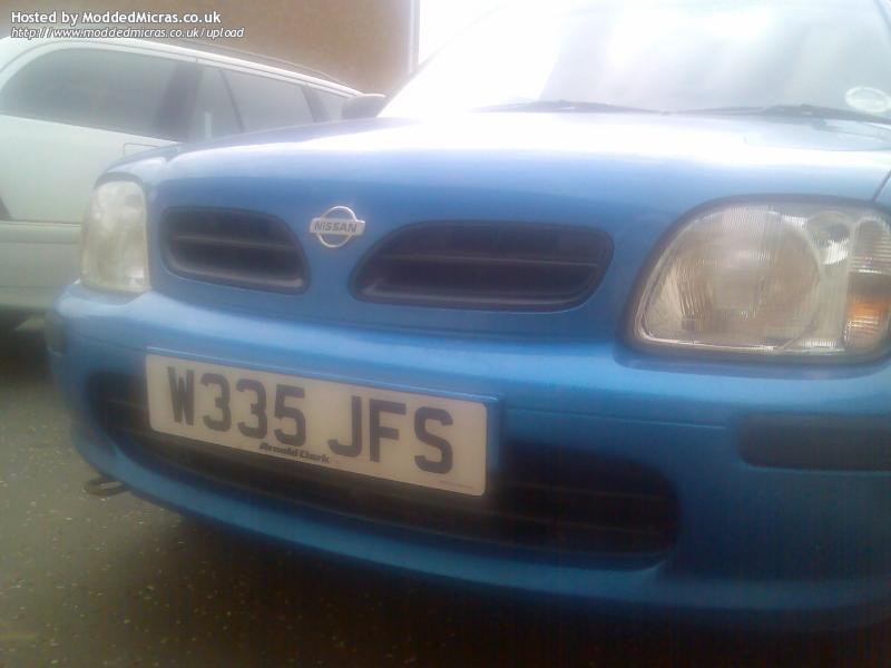

Anyhow.....I went to the scrap yard last week and got a new grill and front 1/4 panel.
To fit the panel I need to take the front bumper off, this is right?
Anyway, I've painted my grill and tried to fit the panel yesterday. After searching around this site I read you need to take the plastic grill off of the front of the bumper. I can only get 2 of the bolts out, because there is almost no gap around the bolt.
Is there a tool which will get the plastic grill off?
Here is a pic, so far:
you might get away with unbolting one side of the bumper. to do this you need to take the headlight out, just a few nuts behind it. you should then see the bumper mounting bracket, remove this. also there's some bolts and clips under the bumper and a bolt into the wing under the arch.
