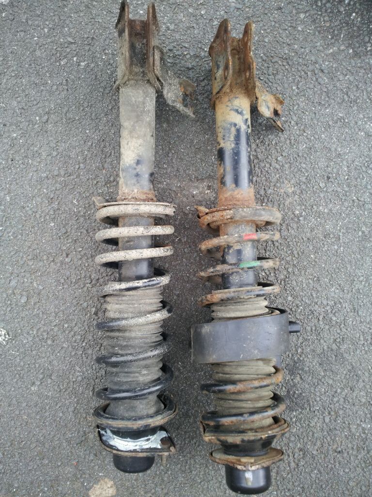

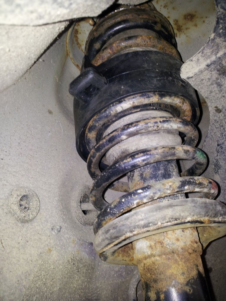

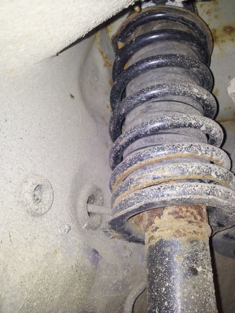

Minimal expense is my mantra too - hence I did this
Rear - get more of the rubber rings which the fit between the spring and bodywork. Disconnect the bottom of the dampers - drop an extra one in the bottom spring cup.
Front - Purchase a pair of spring assisters - usually fitted to the rear springs of towcars and jam em in the front.
http://www.amazon.co.uk/gp/product/B007X4LU5K/ref=oh_details_o00_s00_i00
Before
Swapsies (The strut on the left is wearing my lowering springs)
After
Cost - £14 total
