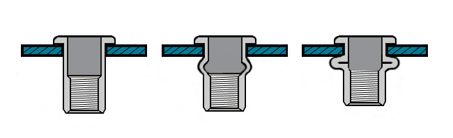

The answer to this was a 'Large Flange M8 Nutsert', a quick phone call to a colleague that still worked in the automotive fastener industry got me a few of these and the loan of a heavy duty placing tool.
I determined where the new clamp point needed to be and fitted the nutsert...
