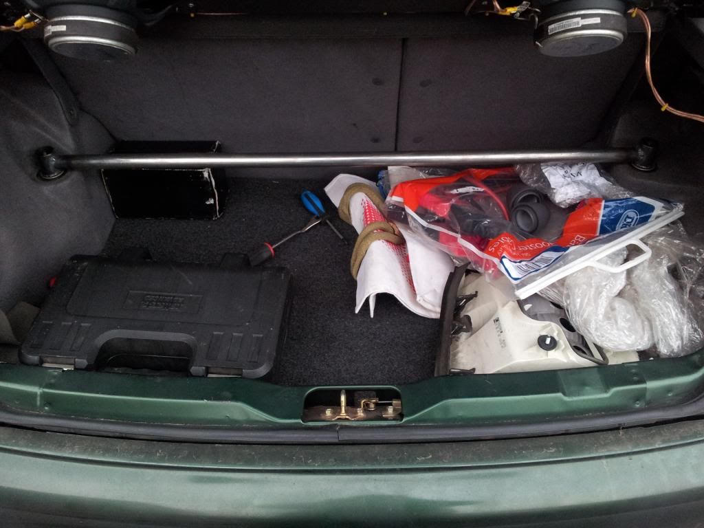

Yeah will try to get some pics up but they are basically as the pics in the first post (but black).Some rear strut's in Stock ?
Thanks for that mate!! I think that represents most micra boots, tools and spare partsSorry noddie, was being a bit lazy, and didnt get a chance to clear out the boot before the pic!

Yeah, the nuts can be tough to get off and on eh? How did you clamp the shock shaft?Received the rod today! Installed it as soon as I got home from work... Bit of a mare installing but lucky my dad had some specialist tooling and an angle grinder at hand! Love it, definately looks the mutts nutts!
It looks like you have mounted it on top of the rubbers from the pic? I would consider removing them to get the brace more solid My plan over the summer is to make proper installation videos for the stuff i make, I just haven't got time at the momenet
Ed
GotchaYep lol! Took a broken extension and ground a slot out that secure it and used my dads centre less socket set to do the nut! Was hard though lol. And yeah it's on the rubbers because otherwise it will float as my threads don't go down far enough. I need to get some washers and put those underneath.

They will make a difference if installed correctly (not with the rubber bush underneath). I will say however that they will not make as much difference as a welded in one between the towers. The reason i make these is i don't think most people want to/have the resources to weld one into their car.Ok cool, do they make much of a difference on like a ''custom'' spring and shock setup? (cut)
Nice one Whats your price again? £45-50 painted?They will make a difference if installed correctly (not with the rubber bush underneath). I will say however that they will not make as much difference as a welded in one between the towers. The reason i make these is i don't think most people want to/have the resources to weld one into their car.
If the demand is there i would happily made some weld in ones. possibly ones which bolt to a plate which is welded in, that way they are not quite so permanent if the owner wants to put something big in their boot.
