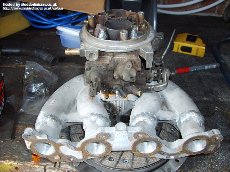

Over taking with a 1.0 isnt all that bad but you usually have to down shift. When i drove Ems's 1.2, going up hills and stuff required no effort at all, and i must admit mine does struggle with that! but maybe that wont be the case with the CBR and 4-1 manifolds.
I'd recommend getting a set of those on yours to unleash some extra power, and maybe just give it a good clean up & service to keep it running nicely.

sorry Dave don't agree with that, the ma10 is a much stronger engine than the ma12. and is used as the base for the Figaro ma10et turbo lump. the ma12 has 5-10 bhp on the ma10 depending on the model of ma10 lump you have and about 10ft/lb of torque. an ma10 with a decent carb and inlet manifold could easily beat an ma12, admitidly an ma12 with the same carb inlet manifold would have more power but which one would blow a head gasket first? i know which one my moneys on ;)
personally i think the ma10 could run more power, more reliably (key word there!) and i intend to prove that theory shortly ;)
