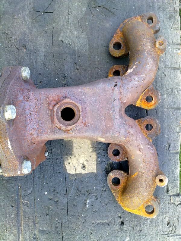

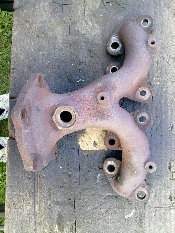

right when i bought my car it was fitted with the standard manifold
absolute pants.

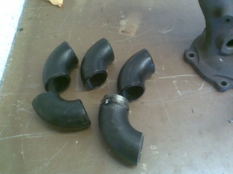

while sorting some stuff in the shed i stumbled across these
so i thought hummm.

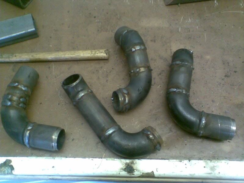

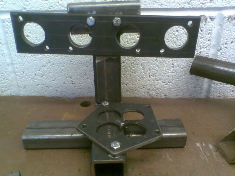

then that was it i had a plan in my head, nothing was going to get in my way, and to make a propper job of it i made this
then is snowballed from there, (i think this is the only project ive done to date where ive half documented its progress, lol)

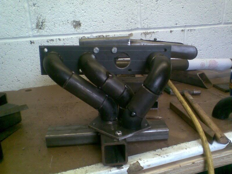

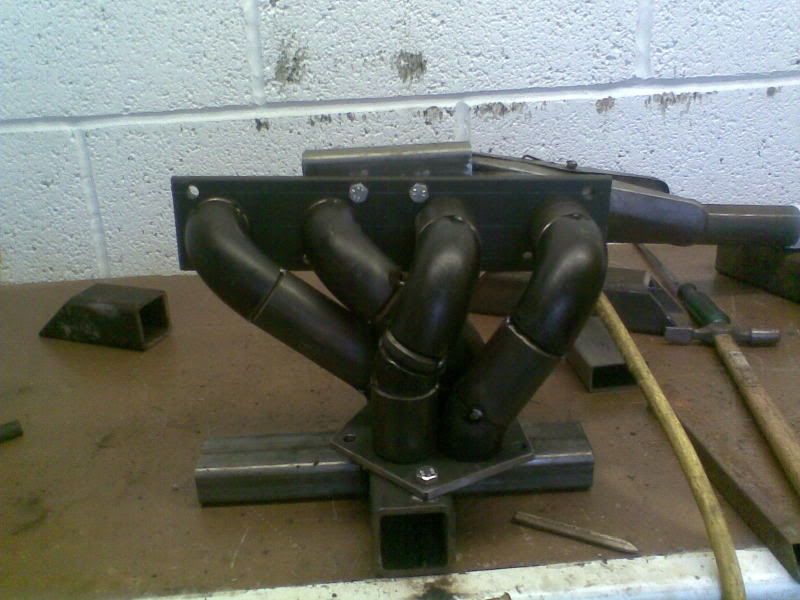

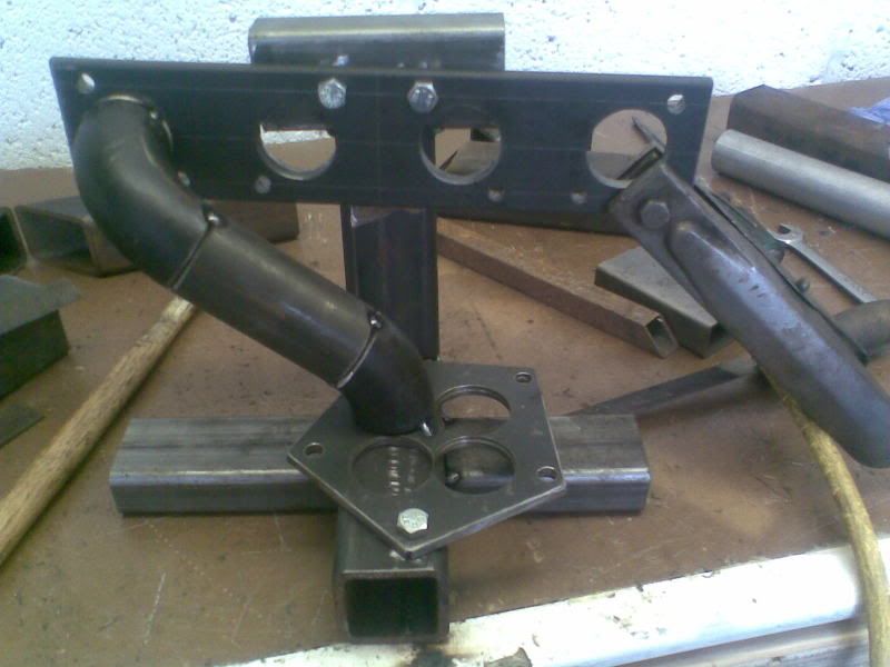

first there was 1
and then there were 2
and what follow 2, yep you got it 3

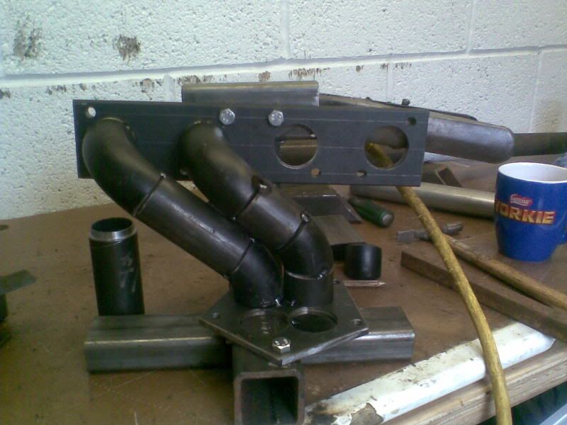

and finally 4
all tacked up
then i split it down and welded the pipes up
tidied the welds up with a flappy disk in the grinder and welded it back together.

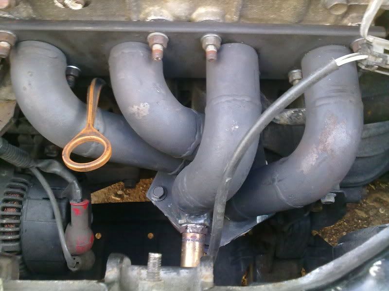

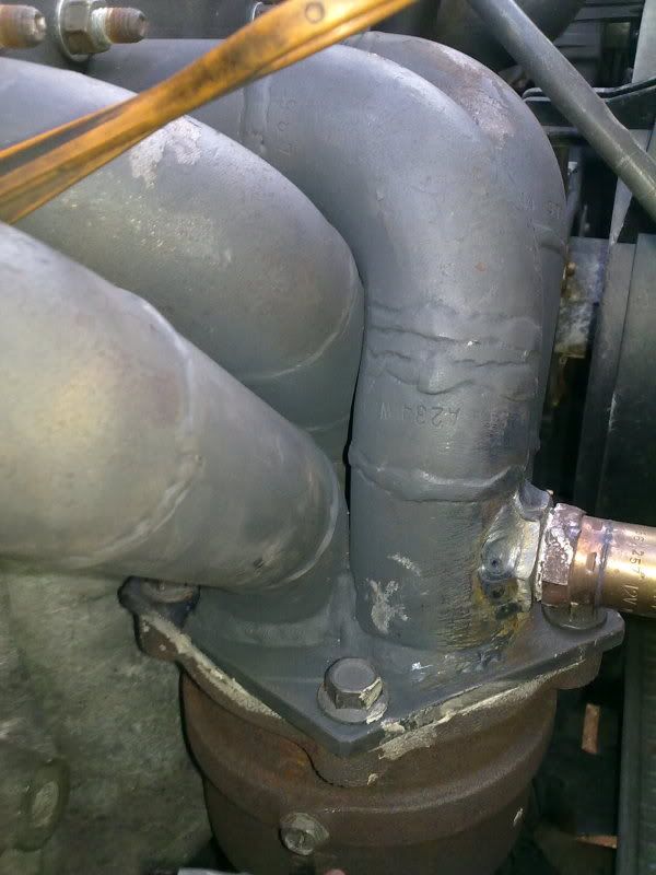

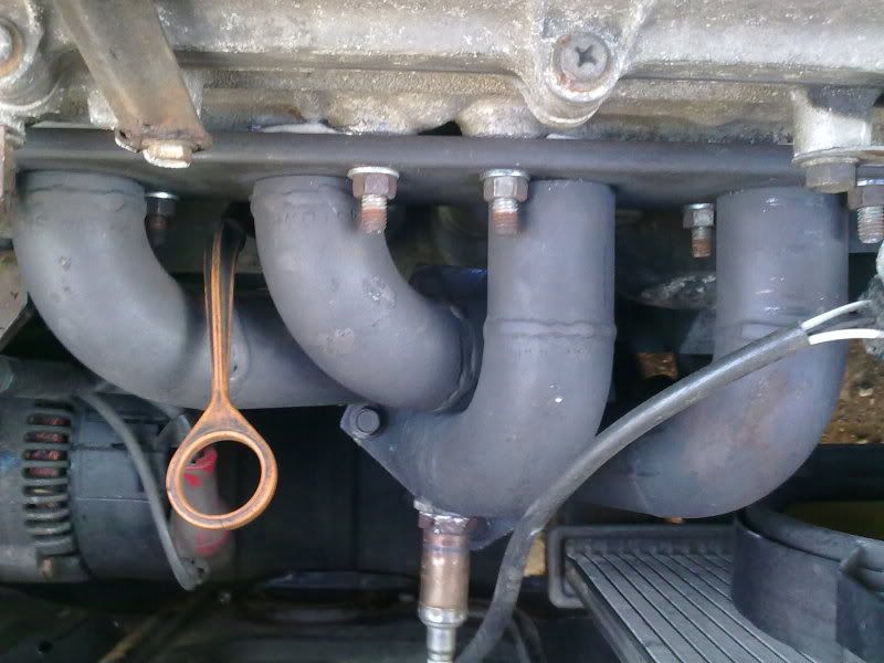

i have no on the bench pics, but here are a few on the car pics
i think it certainly looks better than the stock. and it out performs it in every single way too.

cheers, the sound is a little different, but the entire system is stock bar the decats, for now that is lol
yes by out performs i mean there are very noticable gains, accross the board, its goined more low down grunt then top end, but its a commuter car so thats what im after, i can upll into fast lane at 70mph in 5th and dump the throttle and it picks up really well, to the extent that the nose noticibly comes up.
