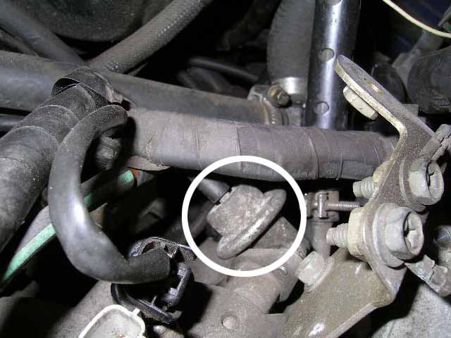

Ive read a few things on both UK and AUS forums with options (from Jaycar or here http://www.micra.com.au/images/community/forums/29861.jpg) but still not 100% on it all.. Kinking the fuel lines seems to be my best option

you don't need bigger injectors to run that setup you've listed. waste of money.. there won't be any gain what so ever. don't be tight and don't kink the fuel line/bash the fuel reg in.. that's just plain dodgy. get an adjustable fuel reg. or at most an apexi safc is all you'll ever need. that said. the stock ecu will run the ga15 injectors with no worry at all.. as there not much bigger then standard injectors anyway.
