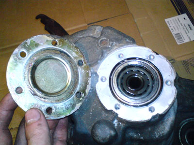

was it this one?
2010-09-319-jpg.32723
this is a cover for the main shaft bearing, too high to drain oil.
to refit this cover, first drain the oil described below so it doesn't leak out the main shaft hole. then dry/the touching faces with brake/carb cleaner for a good bonding surface, then apply a thin bead of sealant to seal it or else it'll leak oil.

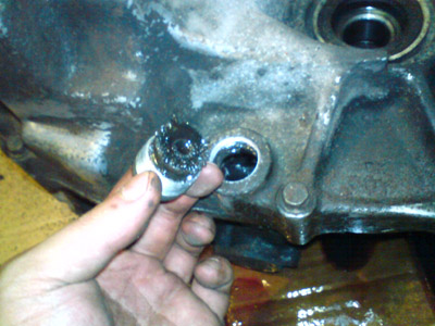

the drain plug is this at the very bottom

it,ll be the (drainplug less) type 41 g/box eh, the ball and spring that locates the selector rod indents i guess
