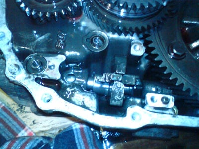

I was just looking back at pics of the disassembled gearbox and here's a pic of the selector pin itself. the middle "striker" bit is what moves the selection mechanism while the blocks on both sides "striker inter-lock" basically lock the other 2 forks in place.
2010-09-331-jpg.33585
http://micra.org.uk/threads/pollymobiles-rebuild.35251/page-11#post-419711
on one side of the interlocker, it has a rounded smooth chamfered edge to help the selector slot into 5th/reverse, whereas the other side has a squared edge, which could be the cause of the notchy 1st gear cos there's no chamfer to help guide it into place made worse by the loose linkages and perhaps restricted movement to the left where 1st/2nd gear are.
so the next time I take the box apart I think I'll chamfer those edges of the interlocker so they're more likely to let the selector mechanism slot in gear.

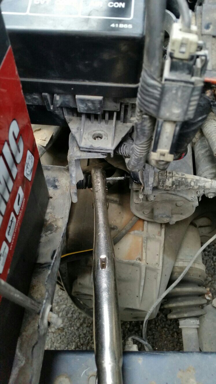

how much throw have you got on the arm ? this is the cable movement on mine (the molegrips were clamped pedal fully down)
i have enough slack that i can just about unhook the arm without slackening the thumbscrew, that gives me a bitepoint about 1/3 rd up

Quite a bit of travel as you can see in the photo so doubt it's the firewall flexing or cable stretch.
