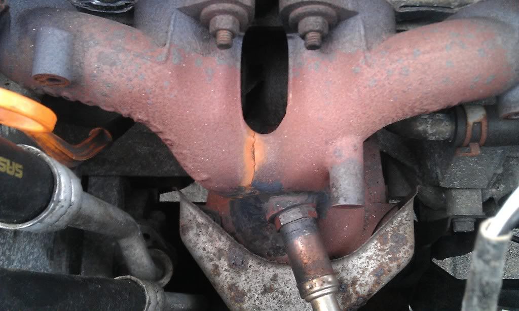

Hi, my name is Robert and I live in the Netherlands. My car is a Micra K11 1.4 from 2001. I have a problem with my exhaust manifold, It's broken.

Have you looked at having it welded? I know cast iron can be welded with nickel welding rods :).
1.0/1.3 are the same as far as i know, and 1.4 have a longer manifold because the cat in it is a bit bigger than the 1.0/1.3
Also you can use the 1.0/1.3 manifold but you would need the whole system changed over, possibly a bit of modification required

thank you all for the answers, what if I replace the manifold and the cat? :p
you could fit the coilpack mani/cat/downpipe assembly eh (downpipe is shorter too), but the coilpack cat has a very fine/dense core, and looked pretty restrictive to me
